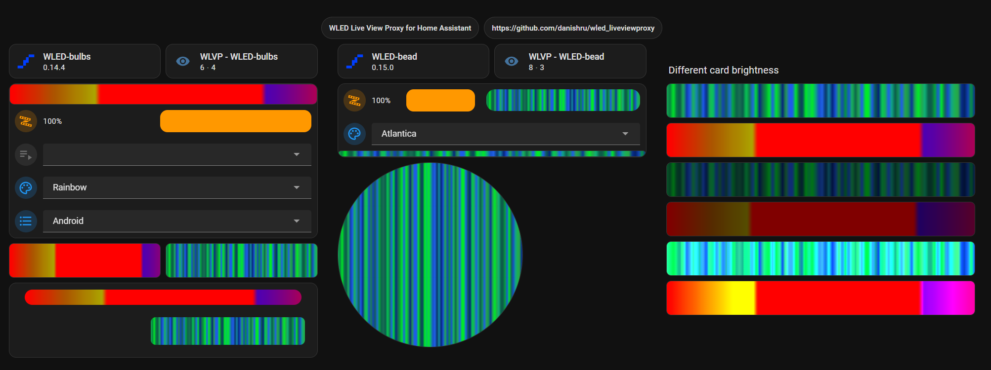

Hello everyone! I think this is the best place to show you my integration, which is a perfect fit for this topic and will make the Still_ill card even cooler! This integration allows you to display the Live View aka. “Peek” of your WLED on your HA dashboard. No port forwarding, no external services, no nginx, and so on… just your HA and WLED. It works in the app and over the internet if you publish your HA. You can install it via HACS or manually, add the card to your dashboard through the UI, and configure it with card-mod however you like! By the way, you can create as many Live View cards as you want, and they’ll all use just one WLED connection. More information and discussion about the integration can be found here: WLED Live View Proxy for Home Assistant.
