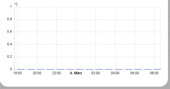

I have created the entity, i.e. hit OK, and then waited until the condition became false. This is how its graph looks:
The blue lines are when the condition is true, i.e. the template returns 0. Once the condition becomes false and this.state is accessed it turns unavailable hence the white gaps.
And, are there errors in the logs? I’m trying to be helpful here but you keep omitting information every time you’re trying to prove your point. I manage the template integration, I need straight answers in order to replicate and fix these issues.
e.g. A proper template using this.state that resolves to an answer will work.
This will be 0 every even minute and 2 every odd minute. All done via the UI and will never be unavailable.
{% if not now().minute % 2 %}
  0
{% else %}
  {{ this.state | int(0) + 1 }}
{% endif %}
This shows you that this.state does work via the UI as long as the entity exists and can update.
So from my standpoint the only issue is that the preview does not work when the entity does not exist and your code path hits this.state.
