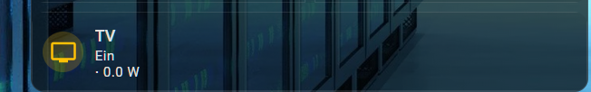

seems like that im in the right place here:
my tile card info is no longer correctly arranged horizontally:

Do you have any ideas?
Did you at least try this?
card_mod:
  style:
      state-display:after {
        content: " āø± {{ states('sensor.tz3000_2putqrmw_ts011f_active_power') }} W";
Exactly that is what i have not tried!

But your solution works - thank you!
