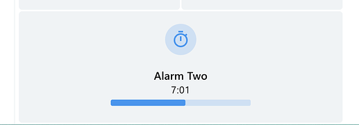

Author here! I tried downloading Metrology theme today and checking how the card looks. I’m not sure if I did anything wrong (downloaded the latest metro.yaml from GitHub along with style.css and the fonts), but the card looks pretty normal:
I’m not sure how the theme is interfering, but seeing there’s multiple of you with the same problem I’d like to fix this!
