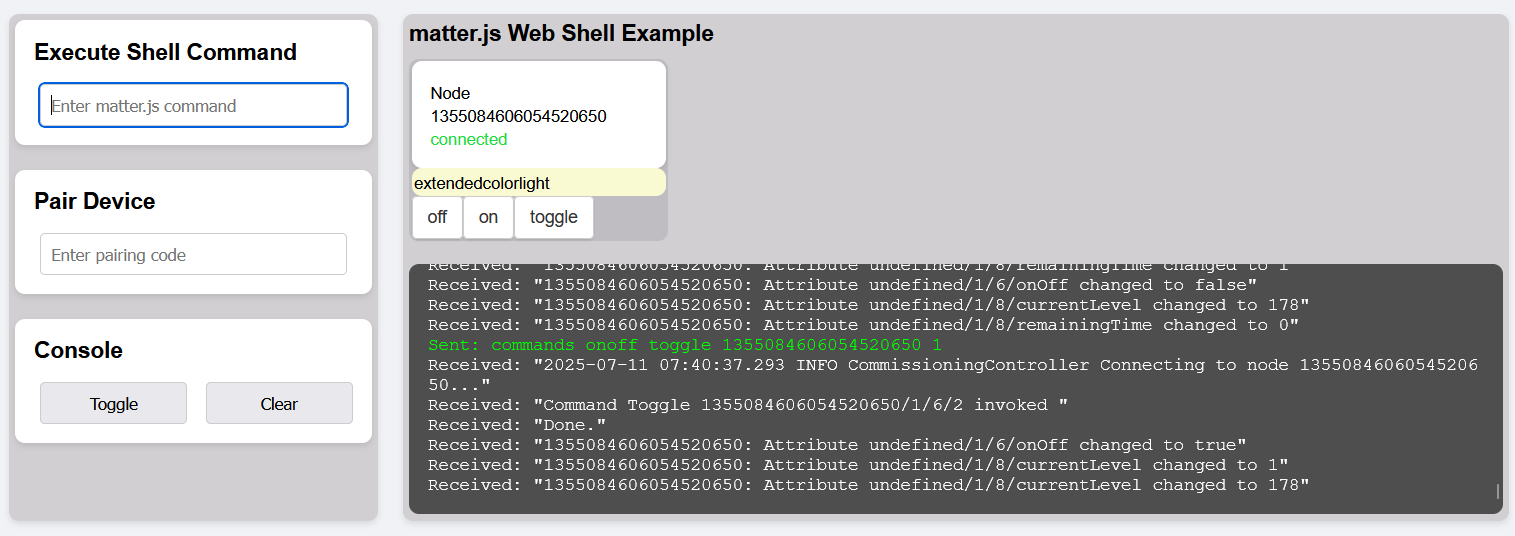

Might see how I can use matter.js, or existing matter controllers based on matter.js, to create groups for my lights…
Was able to install the web-based matter controller example, and commission one of the nanoleaf bulbs on it… and issue on/off/toggle commands. But need to figure out how to add groups, etc
