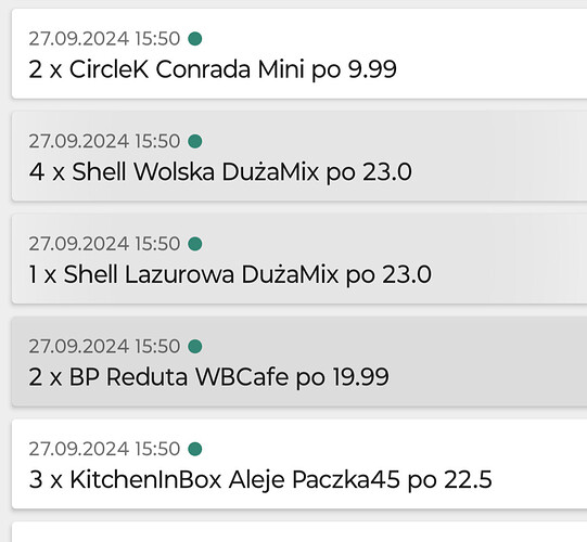

It works, but notifications are only in text form (no clickable links, no image):
Seemingly everything looks like in the ntfy documentation, but where is the error?
