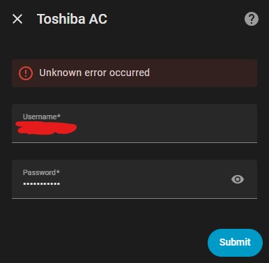

But I was never asked for the user credentials (username:password) for the Toshiba site. I cannot find the button which would bring me to that dialog.
Can anyone help? I sometimes miss the obvious.

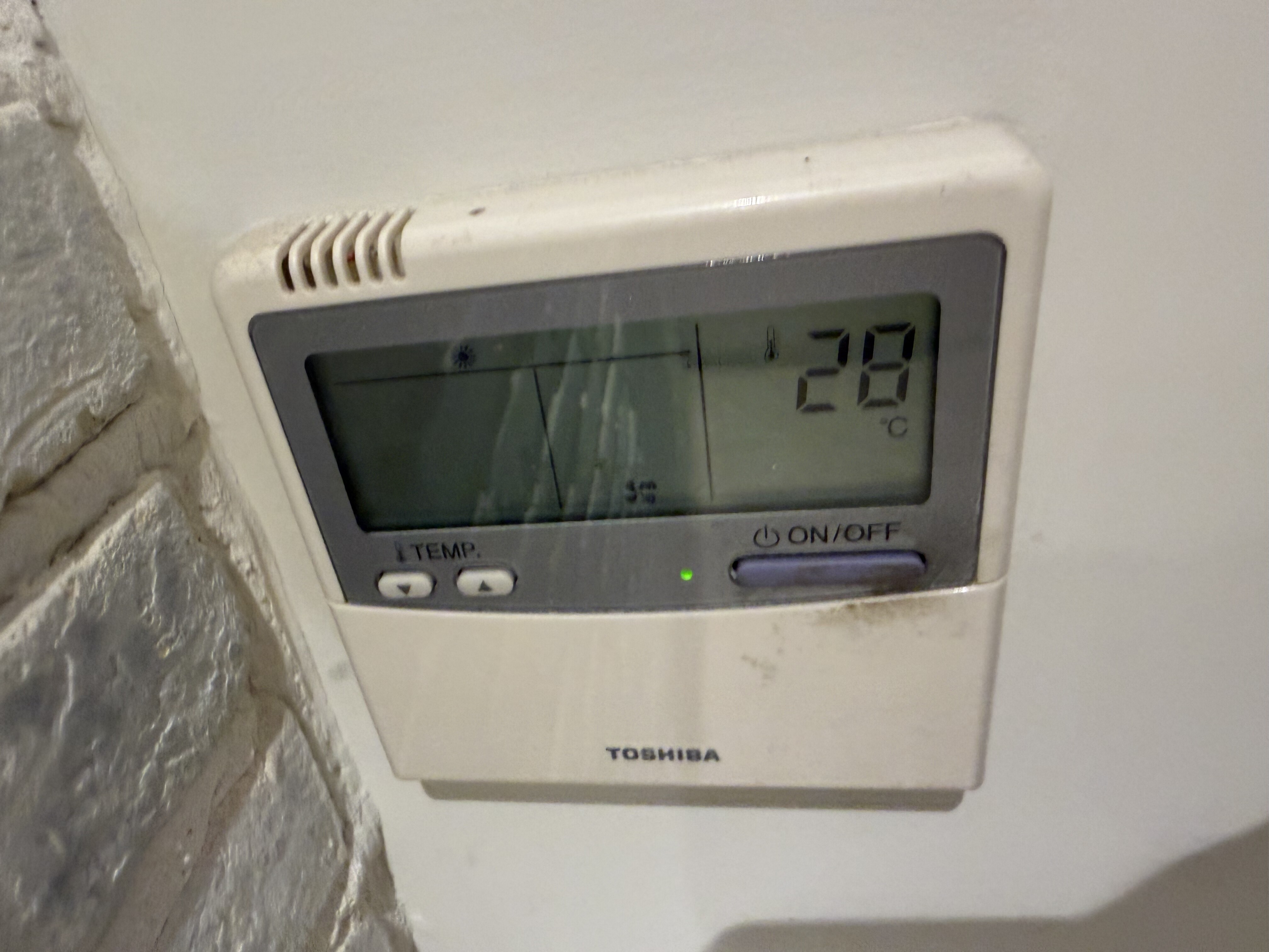

Device (a BMS-IWF0320E) works ok in the official Toshiba app, EU version.
What hardware do I need for this ?
