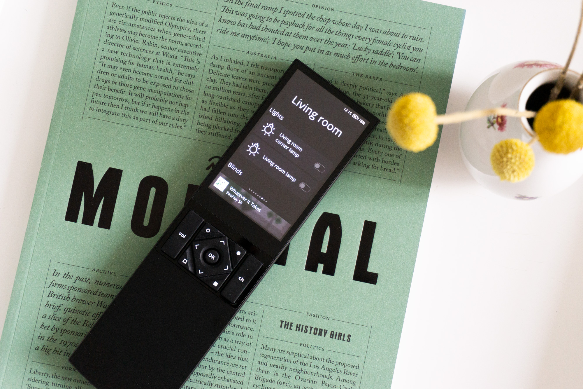

My idea is still that this is a standalone remote that can connect to whatever home automation system you are using. If that is the case, I assume people already have a Harmony hub or other device that can blast IR signals. The dock is there for charging and to display the remote in a nice way.
Still, if you want, you can modify the dock and add all the features you need. For this release, I am not going to focus on adding more and more features to the dock or the remote. I think where it is right now is a good combination of buttons and other features (haptic feedback, etc.).
Somewhere I have to draw the line, otherwise it’s never going to happen. I am trying to take all your feedback and suggestions, but I am distilling it down to what actually fits inside the case or possible to do without drastically increasing the costs or the time it needs for development.
Regarding the buttons, I don’t think that more buttons will solve problems. I think if the UI and the physical buttons work together and create an intuitive interface, there is no need for extra buttons. And that is my goal: combining the buttons with the touch UI in a way that is makes sense.

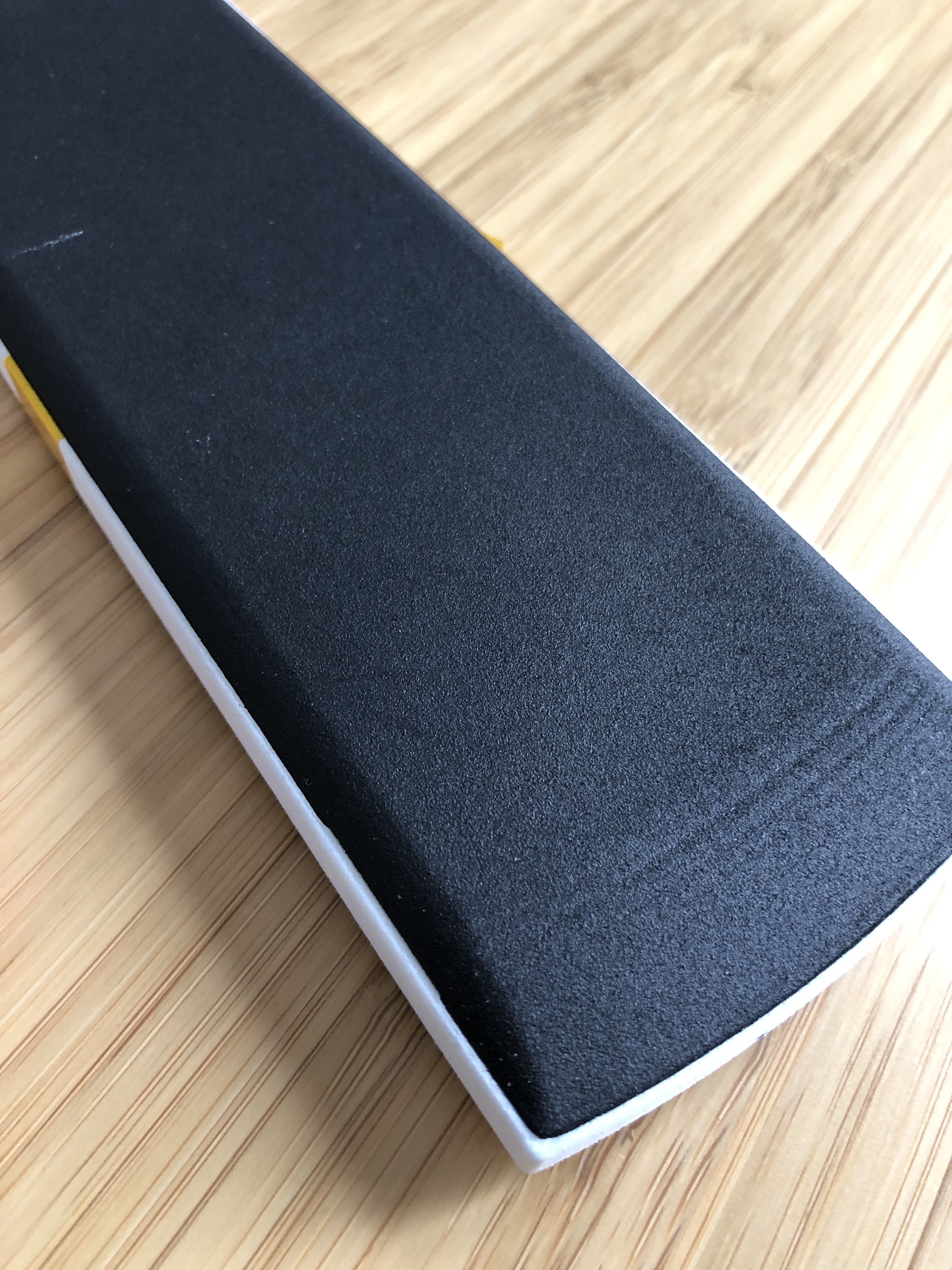

Bead blasted and black anodised aluminium case
3D printed back cover

The price is going to be between $250-$280. This is just a very very early preliminary number and it will change as I get more and more quotes in. It can be more or it can be less. Low volume production is unfortunately not easy and cheap.

Just a quick update. I’ve finalised the schematics for now. Routed the PCBs and placing an order for a couple to test out as prototypes. I’ll report back when they arrive. Hopefully they will work
I have been working on the software the whole weekend. Started from scratch and reworked it to support integrations to not just Home Assistant, but to other systems. Hopefully it will be easy to add more and more integrations. Controlling different entities will be component based. So there will be a component to control lights, blinds, etc. These will just send a high level command, that will be interpreted by the integration. I think this will work.
I’m building 1-2 components to show how I imagined the system and then I’ll push it to github, so developers could pitch in with ideas and help
PCBs, aluminium cases and rubber buttons with silkscreen are on the way. I’m building 2 remotes to test the final materials, design, etc. I’ll report back when they arrive
I have just uploaded a working version of the rewritten software. Only the light component is half-ready so far, but most of the work was done on making multiple integrations easy to add and figuring out how the components should be added.

And last the most exciting thing: Next week, the PCBs and the aluminium case will arrive. Expect a lot of pictures and frequent updates!
For some screengrabs, check out the forum post here:
There has been some progress with the remote. The buttons have arrived and they are working as they should. Here is a post about it:
