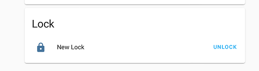

Here is what it looks like in my dev environment
way above my pay grade…can’t wait til it gets its “auto install” certification…thanks Steve
