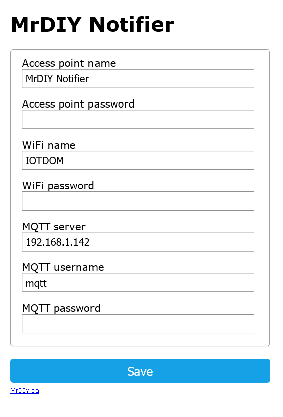

Tried another one…
but not saving… what i do:
  1. tasmotizer it with your firmware
  2. connect to the ssid by phone
  3. fill all fields and (also your password (mrdiy.ca)
  4. it tells me to disconnect wifi (I do).
  5. I can see the device, ping it and it works.
  6. I pull the power, wait, replug an then it is not connected to my wifi but sending out the MrDIY Notifier ssid again…
    And then I can start at 3.
I have also tried multiple D1’s now, same behaviour.
Maybe… what are the fields for:
I tried both:
Access point name and password:
MrDIY Notifier - mrdiy.ca
WiFi name and password
my ssid and password
both not working… (saving)
EDIT: it is very reproducable on both mini’s
Can you go to the local IP address of the device and share a screenshot? I want to see what info is/not being saved.

Extra info: After I thus configure via mobile and i önnect to my own wifi, I get this “plump” sound and then it works. On the mobile I get this:
BUT to avoid misunderstanding: it is never saved to the device.
EDIT: tried the latest bin…
also not working. I noticed that the mqtt topic changed there in deed with a “/”

“if” the wifi password stays saved :-)…
playing MP3 is not really flawless… there are a lot of hick ups in the start and stop of the audio, that “bump” the speaker… But I still love it for letting the dogs bark (that I do not even have :-)).
Then i would use esptool to erase flash on D1 and start fresh.
I know the IotWebConf library doesn’t move away from the AP mode when there are clients connected. Try to disable Wifi on your phone and start the device. This will eliminate the possiblity of your phone trying to connect to the AP and keeping it active.

Thank you kindly for these tips but I have no issue flashing. These minis, 3 same problem, work well with ordinary tasmota (saves well)
