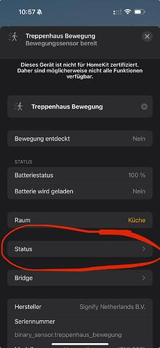

how did you get that working? I’m failing at the point, that the motion sensor will wake up the ipad (iOS 18.5). I found several how-tos describing one essential part: Long press the sensor in the “Home”-App of your iPad → go to status and notifications → enable notification. I don’t have that menu after long/short press of the sensor. I have “Status” only, giving me option to show the sensor on the overview dashboar of Apple Home, but not to set notifications. Any idea?

Forget it, just found out you don’t need that workaround with notifications from homekit-enabled motion sensor. Just create an automation in HA to send a notification to the companion app on the iPad when motion sensor detects motion. The message won’t appear, when you’re in guided access mode.
