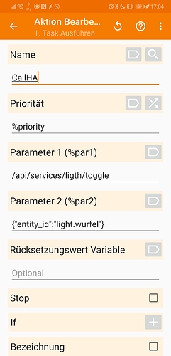

If it could help and save time a bit here is the “Call HASS” xml task :
Call_HASS.tsk.xml (700 Bytes)
You wrote “ligth” instead of “light” in par1…
