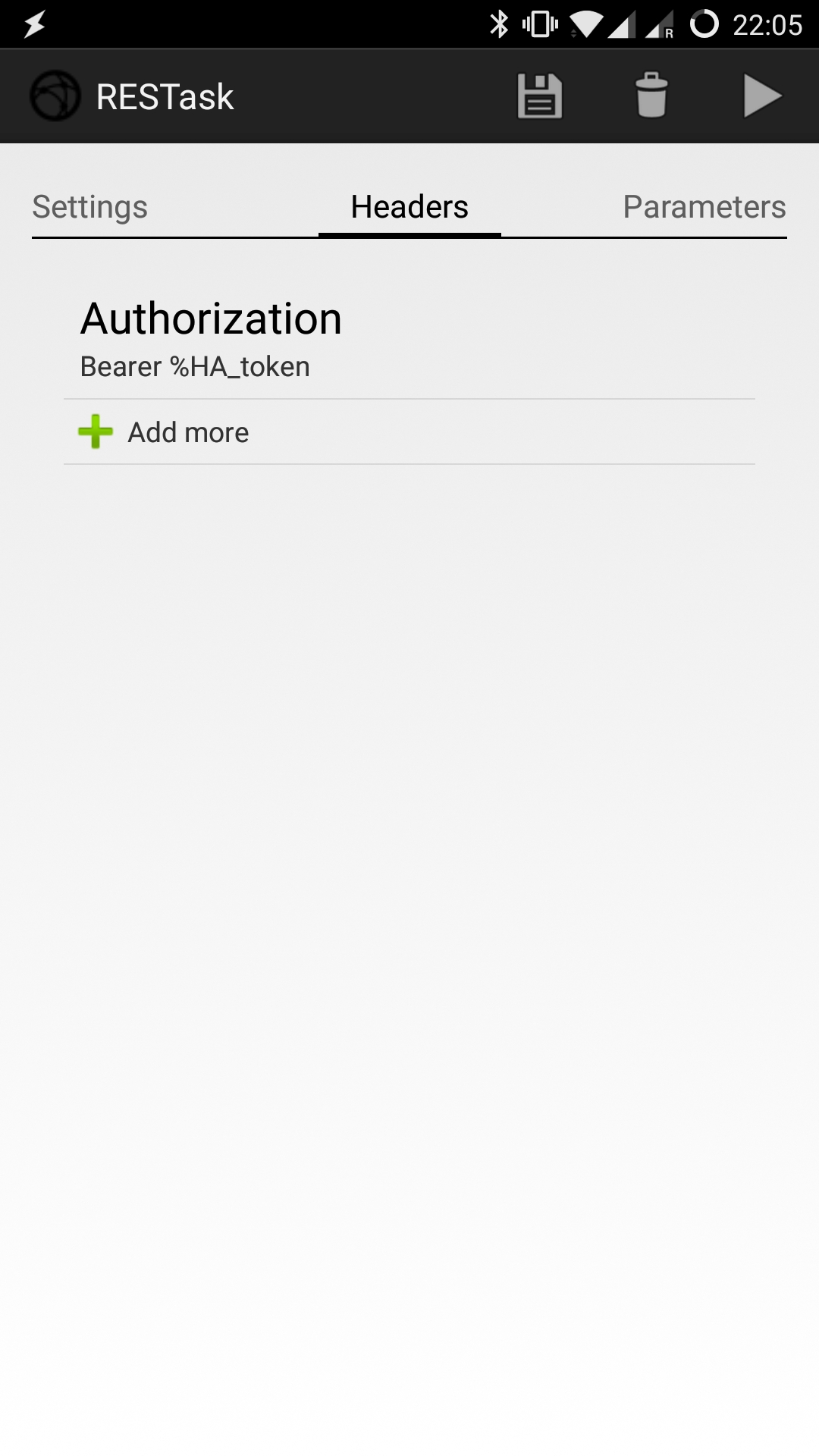

I tried it myself without any luck. I’m using the javascript option for POSTs but I’m still using RESTask for GETs.
I do have RESTask installed, could you share your setting for the GET commands please?
Thank you very much
Here you go. Keep Custom Body unchecked on the settings tab.

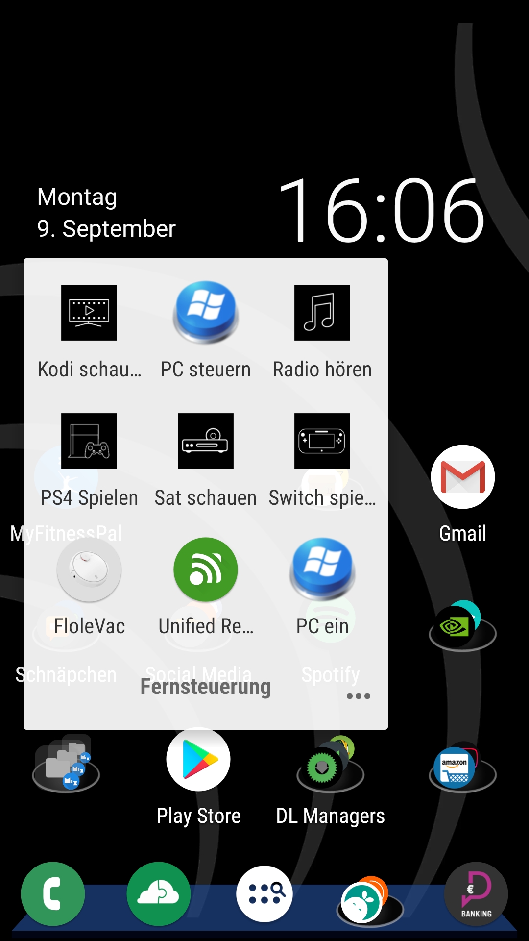

Basically for every harmony activity I’ll create one task. Then I will create a homescreen shortcut to the task. Tapping on it will switch to the activity. Tapping again will send PowerOff.
