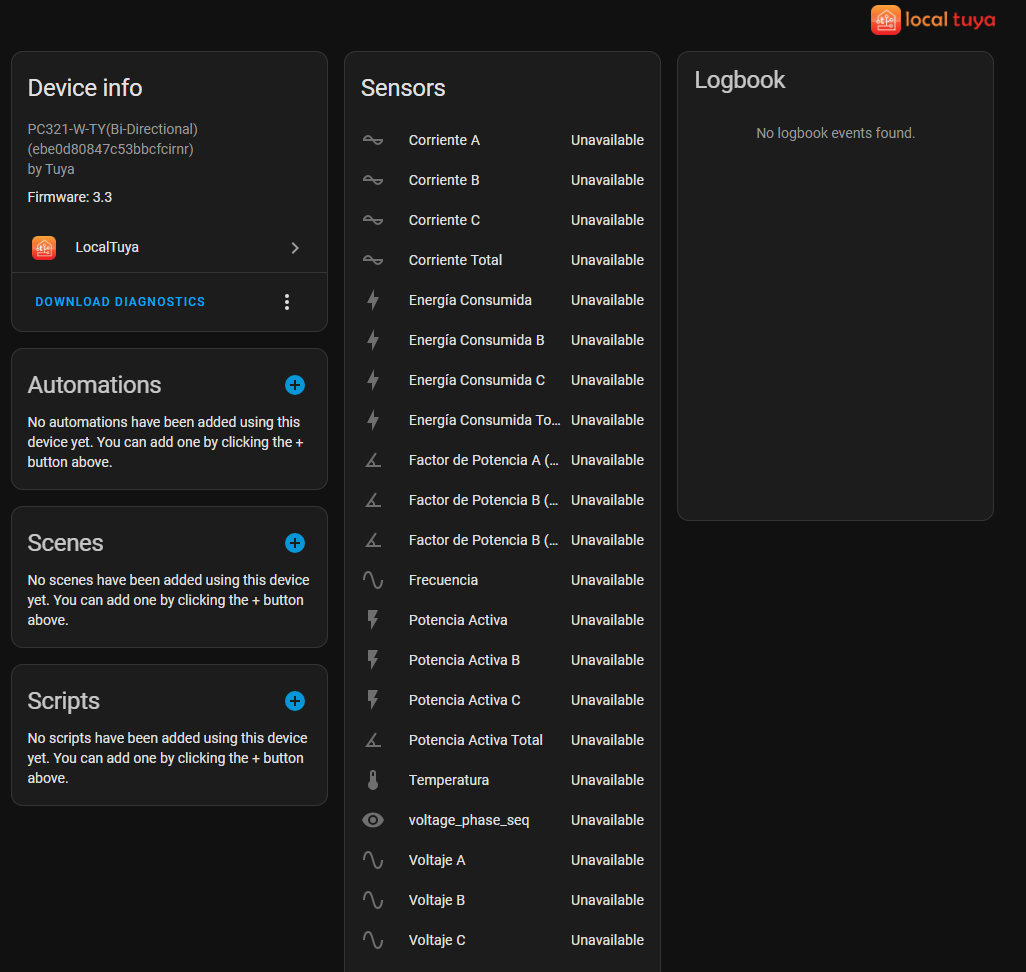

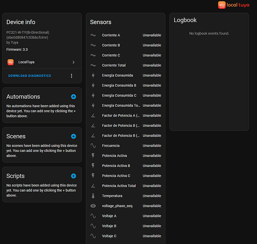

I’m in the same situation as @GreenI.
IF YOU HAVE THESE DEVICES DON’T UPDATE THEIR FIRMWARE.
It was working well in the energy dashboard until today, when I updated the firmware via the smart life app… it stopped working showing “unavailable”:
If someone has any idea how to revert the firmware?
Luckily I didn’t update all devices, those whose firmware is older work fine.
There was yet another new firmware, but no luck. I had hoped it would work again ![]()
Anyone another solution?
