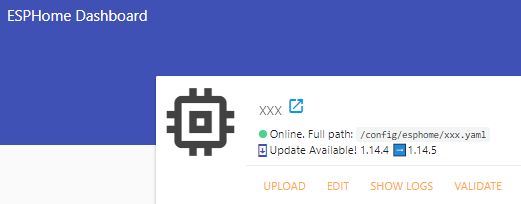

Even if I put the xxx.h file in the xxx folder:
I get this error:
As you can see I can’t upload the configuration.
What else can I do?
THX
What do you expect?
You put a file xxx.h.txt into your xxx folder… And as the answer above your post says, you have to put the correct location in your file, including the folder. So as said, it would be xxx/xxx.h in your *.yaml file and the file should be xxx.h in your folder xxx.
The problem was the format of the xxx.h file.
