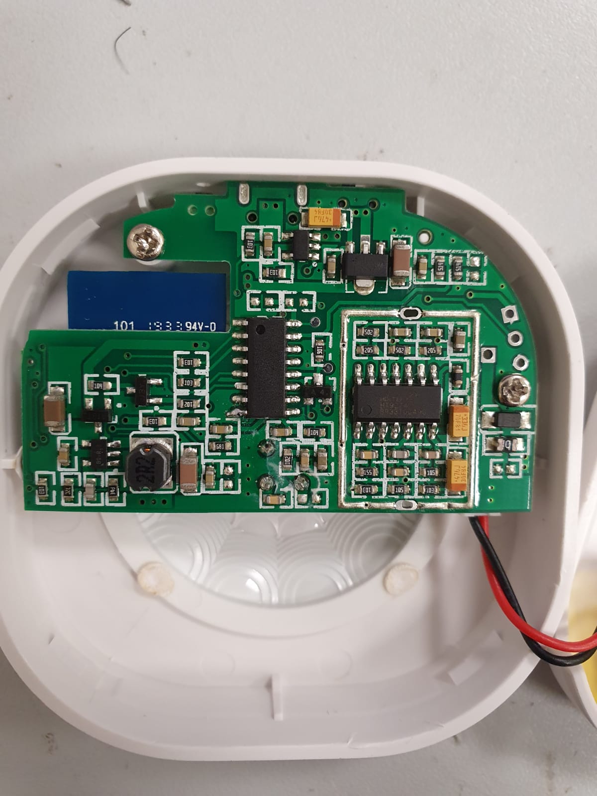

I have tuya pir but not like yours…
I succeeded flash tasmota-battery version also set static IP but when the PIR wake there is no message on MQTT.
Its looks that there is no enough time for the esp boot…
Anyone have any idea or experience with this module?

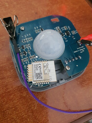

The images for flash / IO2 are misleasing.
The photo with QR code and labelling IO2 is wrong – the flash pin is the one above IO2!
With my PIR sensor I had to put flash on GND during startup (connecting to power).
There are two empty pins between flash (GPIO0) and GND.
There are two empty pins between RX (GPIO3) and flash (GPIO0).
Here’s what worked for me.
  1. During power up hold GND to the flash pin
  2. after power up the flash pin can be left unconnected
  3. flash with tasmotizer.py
Note the flash pin where I hold the black cable connected to GND during power up.
yes, you need to connect to io0 not io2. the labeling is still correct though that’s why i attached the first image.
