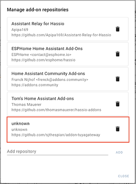

I just added the repository, but it seems that something isn’t configured quite right. The repository doesn’t load up with a name, and once added, I don’t see TuyaGateway listed anywhere. Here is a screenshot of the repositories:
@mikeg1130 Fixed. I left out the json file that described the respository. Since I’m testing locally, i didn’t need it.
If you delete the repo and add it back, it should populate the info now.
Looks good now. I’ve got it installed and running. Now I’ll see if I can figure out where to go from here in the docs.
