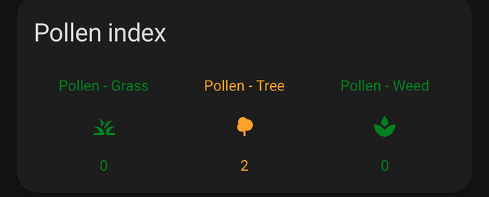

Hello everybody,
in the end I created a card myself.
The result seems pleasant to me.
Below you will find the yaml code to create the card.
type: glance
entities:
  - entity: sensor.pollen_grass
    icon: mdi:grass
    card_mod: null
    style: |
      :host {
            {% if states(config.entity) | int <= 1 %}
            --card-mod-icon: mdi:grass;
            --card-mod-icon-color: green;
            {% elif states(config.entity) | int <= 3 %}
            --card-mod-icon-color: orange;
            {% elif states(config.entity) | int <= 5 %}
            --card-mod-icon-color: red;
            {% endif %}
        :host {
          color:
              green
              orange
              red
            {% endif %}
  - entity: sensor.pollen_tree
    icon: mdi:tree
    card_mod: null
    style: |
      :host {
            --card-mod-icon: mdi:tree;
            {% endif %}
        :host {
          color:
              green
              orange
              red
            {% endif %}
  - entity: sensor.pollen_weed
    icon: mdi:spa
    card_mod: null
    style: |
      :host {
            --card-mod-icon: mdi:spa;
            {% endif %}
        :host {
          color:
              green
              orange
              red
            {% endif %}
title: Pollen index

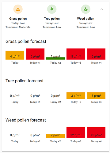

I use all of them in a collapsible card:
That looks awesome! Can you please share your code?
I’m using the Mushroom template card for the majority of it but there are a few other custom cards at play here - stack-in-card, layout-card, grid-layout, bar-card and card_mod:

This is really good!
Do you know why the bar graphs and icon colours are messed up?
I was reading the API documentation and they describe the thresholds between 0-6 - so I put the three colours across those ranges. It looks as though the range is much larger, so anything above 6 will show as blue. You will needto tweak the range’s associated with the colours…I haven’t quite figured it out myself.

        - type: custom:bar-card
          title: Grass pollen forecast
          direction: up
          columns: 5
          height: 50px
          width: 100%
          min: 0
          max: 200
          positions:
            icon: 'off'
            value: inside
          severity:
            - color: Green
              from: 0
              to: 29
            - color: Orange
              from: 30
              to: 60
            - color: Red
              from: 61
              to: 999
          animation:
            state: 'on'
            speed: 1
          entities:
            - entity: sensor.home_grass_pollen_0d
            - entity: sensor.home_grass_pollen_1d
            - entity: sensor.home_grass_pollen_2d
            - entity: sensor.home_grass_pollen_3d
            - entity: sensor.home_grass_pollen_4d
          card_mod:
            style: |-
              .card-header {
                --ha-card-header-font-size: 20px;
              bar-card-backgroundbar {
                background-color: transparent;
              bar-card-name {
                font-size: 12px;
                font-weight: bolder;
                color: #727272;
          title: Tree pollen forecast
          direction: up
          columns: 5
          height: 50px
          width: 100%
          min: 0
          max: 208
          positions:
            icon: 'off'
            value: inside
          severity:
            - color: Green
              from: 0
              to: 95
            - color: Orange
              from: 96
              to: 207
            - color: Red
              from: 208
              to: 999
          animation:
            state: 'on'
            speed: 1
          entities:
            - entity: sensor.home_tree_pollen_0d
            - entity: sensor.home_tree_pollen_1d
            - entity: sensor.home_tree_pollen_2d
            - entity: sensor.home_tree_pollen_3d
            - entity: sensor.home_tree_pollen_4d
          card_mod:
            style: |-
              .card-header {
              bar-card-name {
                font-size: 12px;
                color: #727272;
          title: Weed pollen forecast
          direction: up
          columns: 5
          height: 50px
          width: 100%
          min: 0
          max: 200
          positions:
            icon: 'off'
            value: inside
          severity:
            - color: Green
              from: 0
              to: 20
            - color: Orange
              from: 21
              to: 77
            - color: Red
              from: 78
              to: 999
          animation:
            state: 'on'
            speed: 1
          entities:
            - entity: sensor.home_ragweed_pollen_0d
            - entity: sensor.home_ragweed_pollen_1d
            - entity: sensor.home_ragweed_pollen_2d
            - entity: sensor.home_ragweed_pollen_3d
            - entity: sensor.home_ragweed_pollen_4d
          card_mod:
            style: |-
              .card-header {
              bar-card-name {
                font-size: 12px;
                color: #727272;
Here’s my revised version.
I used Pollen Count – find pollen levels near me | Kleenex to get the values of severity.
I changed the icon-colour, bar-card min/max and positions.
For those adding to your own dashboard, you’ll need to make a “toggle” (boolean) helper to enable the drop down graphs. Link to Helpers – My Home Assistant (home-assistant.io)
Edit: 2022-08-23 20:20 BST - Fixed “high” values appearing as blue (missing “to:” value - set to 999 so all high values are red.)
Hay, can you please help with the code/app needed to get the values from Kleenex please?
Thanks for your amazing work.
