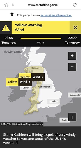

Anyone getting anything show up for storm cathleen?
Should be a yellow warning.
I have mine set to do SW (South West) & Somerset.
Sensor seems to be working so maybe a problem with the card?

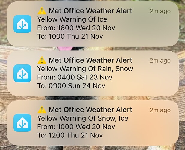

I thought I would share my own automation. It’s has less code and sends a notification for each alert stored in your sensor.
alias: Weather Warnings
description: ""
triggers:
  - entity_id:
      - sensor.weather_alerts_highlands
    trigger: state
conditions:
  - condition: template
    value_template: "{{ alerts is not none }}"
actions:
  - choose:
      - conditions:
            value_template: "{{ alerts | length > 0 }}"
        sequence:
          - repeat:
              for_each: "{{ alerts }}"
              sequence:
                - choose:
                    - conditions:
                          value_template: |
                            {{ 'Highlands' in repeat.item.summary }}
                      sequence:
                        - data:
                            title: ⚠️ Met Office Weather Alert
                            message: >
                              {% set summary =
                              repeat.item.summary.split('affecting')[0].strip()
                              {% set times = repeat.item.summary |
                              regex_findall('(valid from (.*) to (.*))',
                              ignorecase=True) %}
                              {{ summary | title }}
                              From: {{ times[0][1] if times and times[0] else
                              'Unknown' }}
                              To: {{ times[0][2] if times and times[0] else
                              'Unknown' }}
                          action: notify.notify
variables:
  alerts: "{{ state_attr('sensor.weather_alerts', 'entries') }}"
mode: single

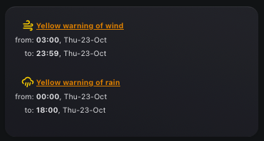

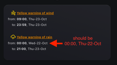

During summer time if the utc start time is 23:00 so the local start time correctly shows 00:00 but the date from still shows the previous day, is there any way to correct this?
I’m seeing it as well (for the first time). Will take a look later.
Edit: It’s a little more complicated as I first thought because the date that the Met Office provides is not formatted for easy manipulation. I’ll need a few days to think the though.
EdIt 2:
OK, here is a slightly dodgy quick workaround which will still be wrong if the warning is in a different month/year (but will fix the current problem). I will continue to work on a proper fix over the next few days
Change these 2 lines:

Edit 3:
OK here is the month fix (and I think there is no year problem). Paste the following over the 2 set date_from & set date_to lines
                {% set month =
                  'Jan':'01',
                  'Feb':'02',
                  'Mar':'03',
                  'Apr':'04',
                  'May':'05',
                  'Jun':'06',
                  'Jul':'07',
                  'Aug':'08',
                  'Sep':'09',
                  'Oct':'10',
                  'Nov':'11',
                  'Dec':'12'
                {%- set date_from = (now().year ~'-' ~ month[summary[2][12:]] ~'-' ~ summary[2][9:11] ~ ' ' ~ time_utc_from ~ "+00:00")  | as_datetime | as_local |as_timestamp | timestamp_custom('%a-%d-%b') %}
                {%- set date_to =   (now().year ~'-' ~ month[summary[3][12:]] ~'-' ~ summary[3][9:11] ~ ' ' ~ time_utc_to ~ "+00:00")    | as_datetime | as_local |as_timestamp | timestamp_custom('%a-%d-%b') %}

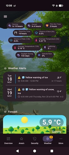

🌨️ Whether warnings as calendars 🌨️ As I said before this could really do with having a way to update events, as currently if a weather warning changes then it will duplicate it. I'm not sure what timescale Met office posts the warnings in, maybe it's just a simple case as looking at future events and re-writing those.
Edit: TIL there is no delete calendar event… so scratch that for now

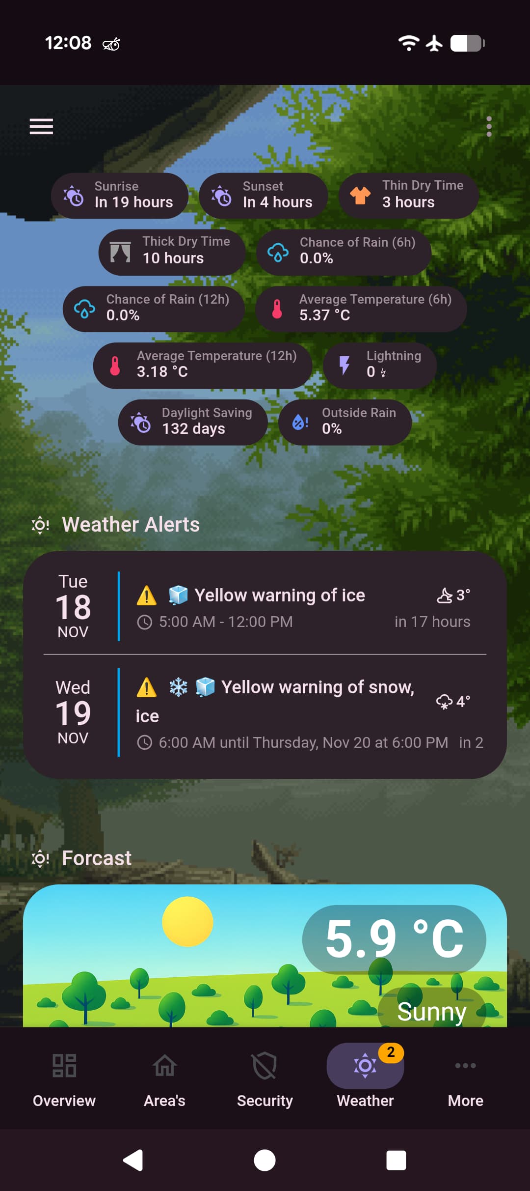

One thing I am not sure about is the way you put the alerts in your dashboard.
Please can you show us. eg: which card?
