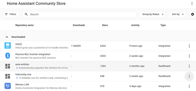

Some of my Tasmota devices have been dropping off the WiFi network and manually looking for those periodically has been driving me nuts so this is a godsend.

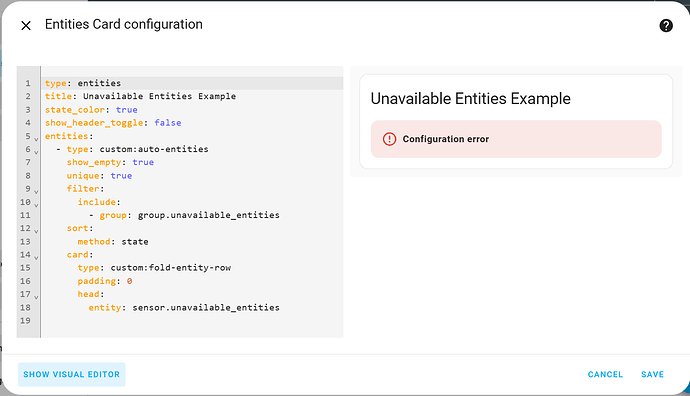

I set it up as a package and tried to use your example card but it gives me a configuration error. If I look at group.unavailable_entities manually, though, I can see the unavailables and the unknowns.
Where do I start looking to debug this?
Also, is there a quick way to filter out the unknowns and only show the unavailables as the first filter?
Thanks
Posting the configuration error would be a good start! Let’s get it working then worry about customizing it later.

I’m using the same config as before but a newer version of HA and the dashboard tells me there is a Configuration Error. Where would I go to look for additional details on the error?
Thanks
