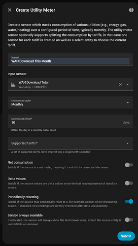

So using the UniFi WAN Download sensor, create an intregral sensor:
Then a utility meter using the new sensor you’ve just created ( Offset 10 days ):

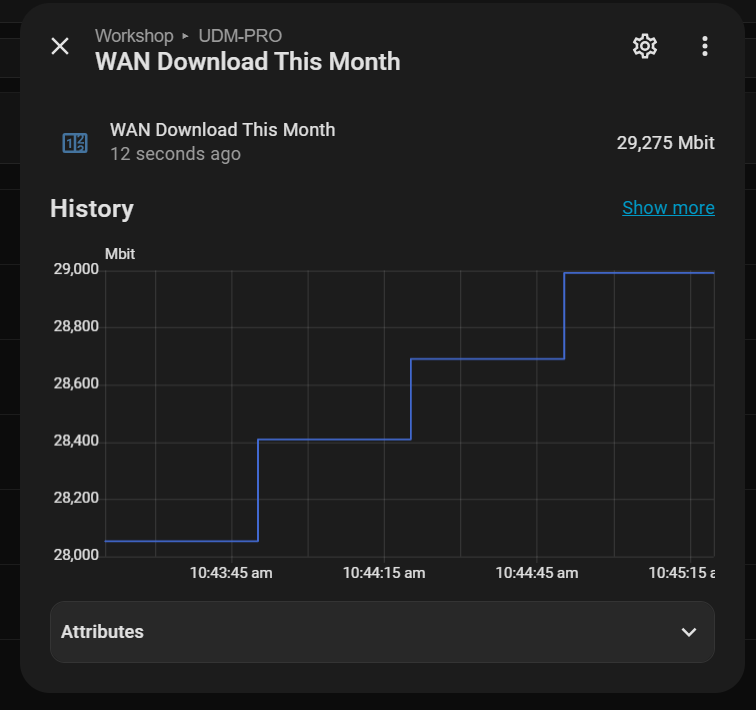

You should end up this:

If you follow the 2 steps above it will create the sensor you need
This is brilliant and working perfectly. I spent nearly 3 days on chatgpt trying to achieve this, it made a real mess. It seemed a simple thing but was driving me mad! Can’t express gratitude enough. Have you a “buy a coffee” link?
