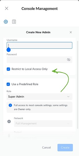

Just create a local user in you Concole (e.g. UCK).

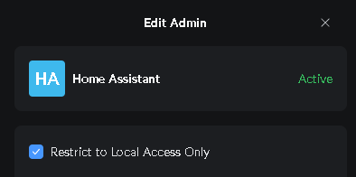

I did it through the UniFi mobile app, under Settings > Admin Management, making sure the Local Access Only option is checked. Then use this to login in HA.

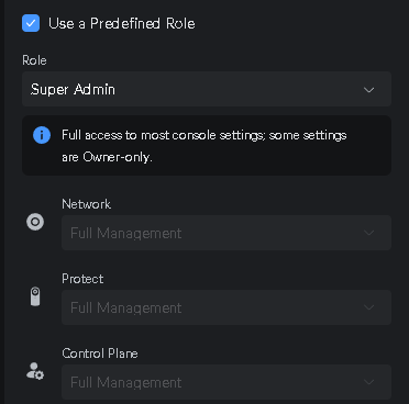

OFC you need a local user that we all know :slight_smile:
This user needs to be an Admin type user with those permissions:
After that you should be able to add any Ubiquity integrations using creds for above user.
