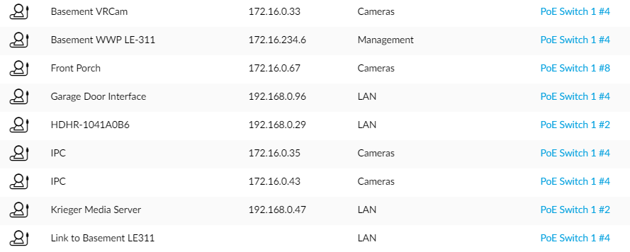

I have wired devices that show up as connected to my PoE switch and not an AP, is that what you mean?
yes! I didn’t thought about that as I don’t have other “wired” devices! I put a python script here that will print your devices information in json. At the bottom of the file you should edit your user/pass/ip at the line “api = API(username=“admin”, password=“your_password”, baseurl=“https://your_ip:8443”, verify_ssl=False)”.

One more thing… How should be the better way to present information about wired devices? From your image it seems that they use the “network” attribute (LAN or Cameras in your case) or we may just list them as “wired”.
Well LAN or Camera refer to the VLANs that they are connected to. I could see how that would be nice to use, but I don’t see why just Wired wouldn’t work.
