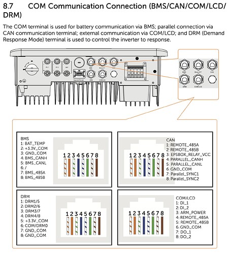

Can anyone with a Gen 4 SolaX advise on the correct connection point for RS485?
We’ve got a X1-Hybrid-5.0-D generation 4.
According to the manual there are four ports that expose RS485:
  • Meter/CT (pins 4/5: 485A/485B)
  • BMS (pins 7/8: BMS_485A/BMS_485B)
  • CAN (pins 1/2: REMOTE_485A/REMOTE_485B)
  • COM/LCD (pins 4/5: REMOTE_485A/REMOTE_485B)
The diagrams and designations in the manual don’t quite match the documentation for this project (which I presume were written for an earlier revision).
In the manual the menu settings say the Meter/CT uses modbus IDs of 1 and 2 for the meters, which suggests that port has the inverter acting as a modbus client with the meters being modbus servers?
The manual has COM/LCD used for connecting Adapter Box G2 (modbus ID 96), EV-Charger (modbus ID 70), and DataHub (modbus ID 1), all at 9600 baud by default. So that also doesn’t seem to match using the inverter as modbus ID 1 at 19200 baud?
Should we use the CAN RS485 connections then?
Has anyone got this working successfully with a Gen 4 SolaX, and if so which connector, baud rate, and modbus ID did you use?
Thanks!
Manual extract for reference:
For anyone else looking for the answer, we managed to get it working both on the COM/LCD port and on the CAN port.
