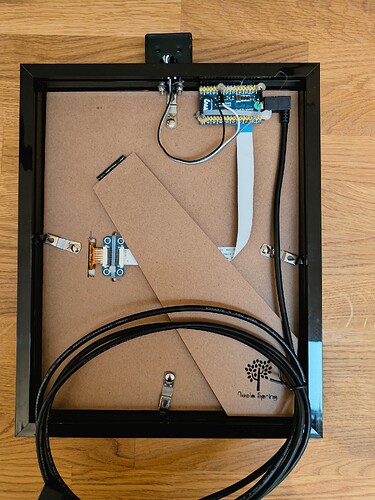

Hi, I made my own screen last weekend. Thanks everyone for the pictures and tips. This was a nice project, I learned new things. At the bottom of the screen you can see the electricity prices that come from the Nordpool sensor. Now you no longer need a phone to check prices.
Thank you @ToHi. Yesterday I noticed black dots on my screen when the sun hit it. Today I tested it with a flashlight (my screen went black) and inverted the busy pin. Inverting also removed the error message from esp’s log that came when the screen was updated.
Finally managed to customize the display as desired. Thanks everyone for the code (examples). Unfortunately getting an issue when the temperature is below 0 degree. The “-” symbol is not shown correctly. Any ideas why?

# Now render everything on the ePaper screen.
display:
  - platform: waveshare_epaper
    cs_pin: GPIO15
    dc_pin: GPIO27
    busy_pin:
      number: GPIO25
      inverted: True
    reset_pin: GPIO26
    reset_duration: 2ms
    model: 7.50inV2
    update_interval: never
    rotation: 90°

[16:50:42][D][main:020]: Initial sensor data received: Refreshing display...
[16:50:42][I][waveshare_epaper:1663]: Power on the display and hat
[16:50:53][E][waveshare_epaper:1608]: Timeout while displaying image!
[16:51:05][E][waveshare_epaper:1608]: Timeout while displaying image!
[16:51:05][W][component:214]: Component esphome.coroutine took a long time for an operation (23.18 s).
[16:51:05][W][component:215]: Components should block for at most 20-30ms.
Is this related to faulty hardware? The only difference between OP’s setup and mine is I use a RESTapi for transit information.
Partially resolved as per this issue
Under the display settings,:
busy_pin: GPIO25
needs to change to:
busy_pin:
      number: GPIO25
      inverted: true
It’s now taking 8s to refresh the display. Is that the expected amount of time?
