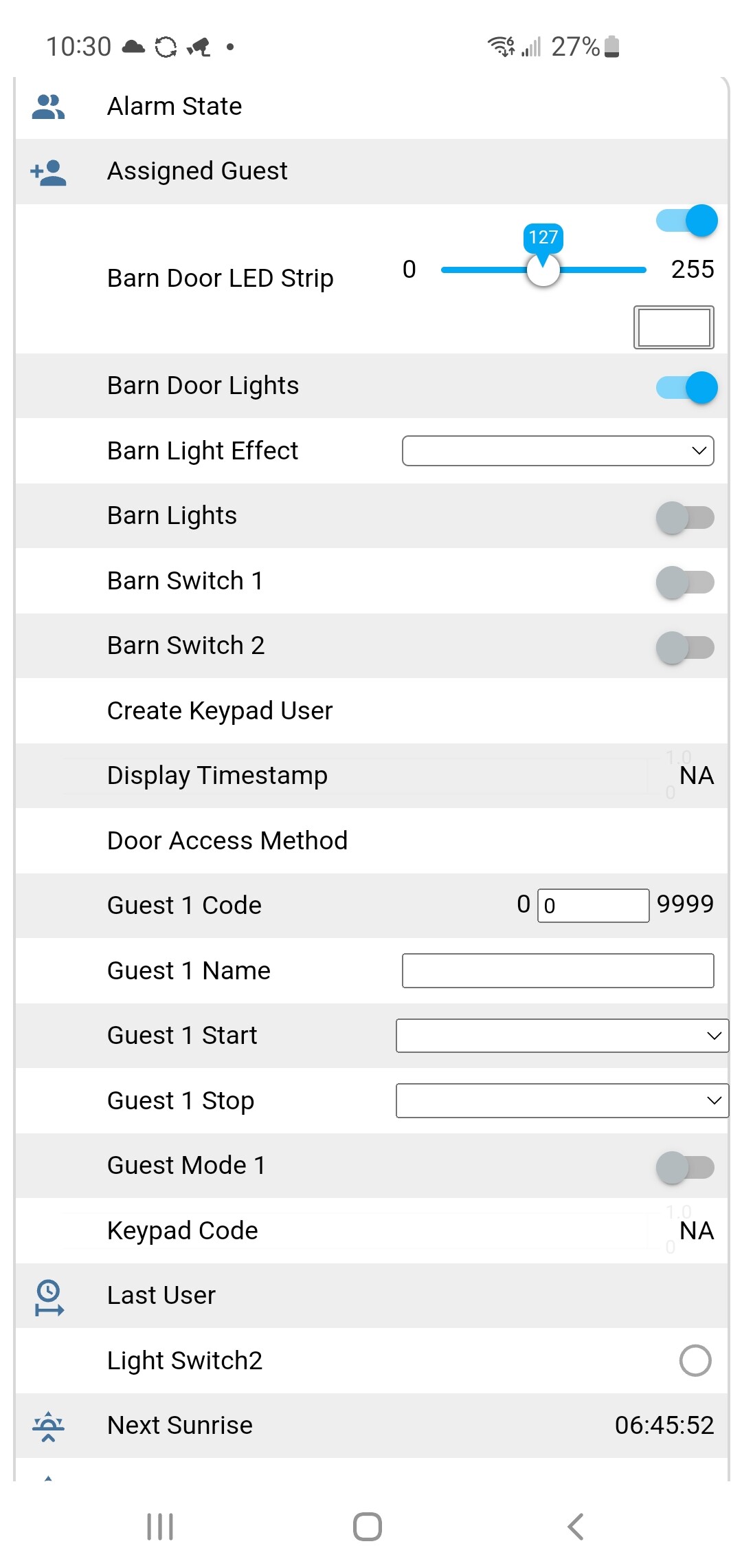

This is for my kepad for the garage door. Because i created all the schedule configs and adding new users/pin codes etc in Esphome, they aren’t only just added to HA to be used there but, in the event of a “bad day” and HA calls in sick. I wont be left with 0 options or ways to access the keypad and for example disable a lost/stolen RFID tag so that it can’t be used by someone unauthorized. I can simply access it through a browser and do what i need. Had i created those functions through helpers in HA then none of it would be available without HA and i believe they call that, “Bent over a barrel”

Whether you create the number entity via a helper in HA or you use the Number entity that you create in Esphome that is then added to HA, both ways will set the time on the esp device itself. Where they differ and that wont work is if your wifi goes out for example and HA cant communicate with the esp device to update it or tell it that time number you specified. If you created it your Number entity in Esphome and set the time from your HA Number entity and then your wifi goes out like the last example, the Time number will not be effected and will be whatever you set it to in HA, even if it cant communicate back with HA it doesnt matter. The other benefit is if while your wifi was down and you needed to change that Time number, you can do it without needing to use HA only because that Number entity was created in Esphome and its all together and stored on that esp that you can then access without having to go through HA.
