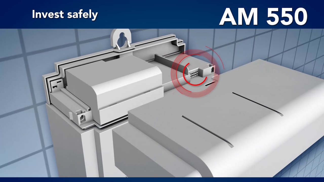

But there is a more interesting question, which I want to ask you. Does the operator there provides information on the remote disconnector built into these meters?
@GSzabados Interesting question…You mean the possibility for your electricity supplier to cut off your power supply remotely ? Are they able to do so ? Indeed, they don’t say anything about this possiblity. Do they in Poland ?

Around 0:33…
Yes, there is a disconnector inside, some companies even sealing the lower button, which is for engaging it.
