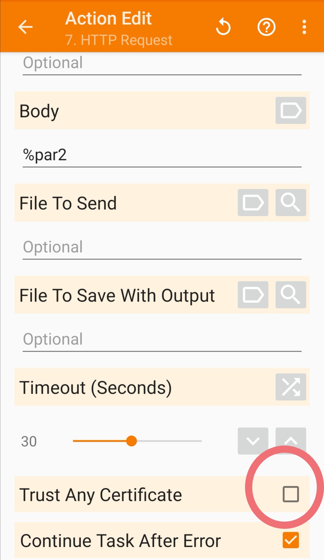

I’m getting the usual unverified SSL error:
javax.net.ssl.SSLPEERUnverifiedException: Hostname 192.168.10.61 not verified
How can I surpass this issue?
Thanks.
Even with self signed certificates for local access, now the error changes to:
javax.net.ssl.SSLHandshakeException: java.security.cert.CertPathValidatorException: Trust anchor for certification path not found
Any help is appreciated, please.
Thanks.
Can you open the HA call-service task, go to action number 7 (HTTP Request) , and check “Trust Any Certificate”?
If it works, I’ll edit my tasks
Thanks, bokub. That’s solved!
But now I get “401 unauthorized”. That is odd as the token is correct and valid. I’m on HA 0.102.1.
Solved by removing the Authenticated plug-in (https://github.com/custom-components/authenticated), deleting the existing token and creating a new one.

Great news! I’ve updated the two generic tasks with the “Trust Any Certificate” set to true so future users don’t encounter the problem
I was testing this but I get: “javax.net.ssl.SSLhandshake Exception : handshake failed”
is some one experince this also? and how did you fixed it?
Is your HA_ADDR http or https ?
Is your HTTPS working properly ?
Can you open the HA call-service task, go to action number 7 (HTTP Request) , and tell me if “Trust Any Certificate” is checked ?
Number 7 is checked.
without http(s):// I get the ssl error. And with http(s):// it is changed to Unable to resove host “https”: no address associated with hostname.
but if I put the same name in the browser it gets to the right address (http://xxxxxxx.duckdns.org:8123/)
If http://xxx.duckdns.org:8123 works in your browser without any error or warning, you have to set HA_ADDR=http://xxx.duckdns.org:8123, without any trailing slash.
I don’t understand how you could have a javax.net.ssl.SSLhandshake Exception if you’re not using HTTPS.
