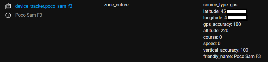

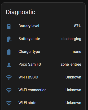

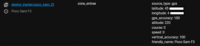

As I’m also new, I’m having some isue to understand, and integrate this feature to my Home Assistant.
First, I don’t understand how to get the phone SSID, because it’s not an attribute of my device:
Also, on my device info I enabled all the attributes that look like SSID or Wi-Fi interesting but I still don’t have the SSID:
How do you get the phone SSID please?
It finally worked today, sorry for disturbing!
