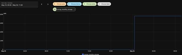

Utility meter sensor randomly shows incorrect readings, summing up the energy sensor readings.
I have no idea WTF how to fix my trouble.

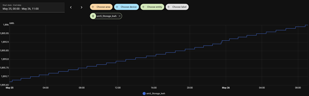

The energy sensor has no abnormal values, but monthly energy sensor shows wrong values…
Sensors:
em5.storage_energy_kwh (modbus)
#===== Storage Active Energy (kWh) =============#
       - name: em5_Storage_kwh
         unique_id: em5_storage_kwh
         slave: 5
         address: 342
         scan_interval: 60
         input_type: input
         data_type: float32
         device_class: energy
         state_class: total_increasing
         unit_of_measurement: kWh
         precision: 2
Monthly energy (utility meter)
sensor.energy_monthly_storage
  energy_monthly_storage:
    source: sensor.em5_storage_kwh
    unique_id: energy_monthly_storage
    cycle: monthly
    always_available: true

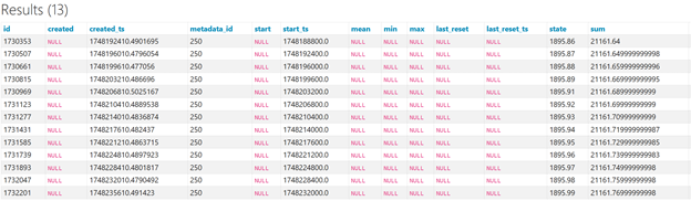

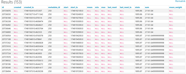

Sensors data in HA database:
States
SELECT * FROM states WHERE metadata_id=131 and last_updated_ts>1748192400.0
Statistics
SELECT * FROM statistics WHERE metadata_id=250 and created_ts>1748192400
Statistics_short_term
SELECT * FROM statistics_short_term WHERE metadata_id=250 and created_ts>1748192400

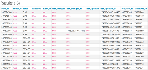

States_Meta
SELECT * FROM states_meta WHERE entity_id LIKE 'sensor.energy_monthly_storage'
States
SELECT * FROM states WHERE metadata_id=968 and last_updated_ts>1748192400
