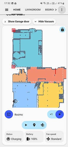

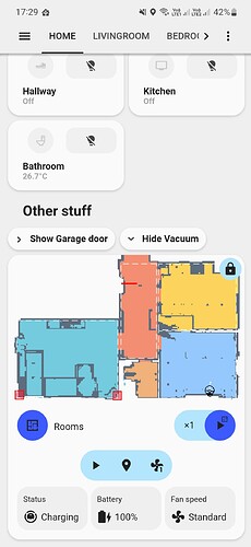

I don’t want to trim it, but rather scale it, as in how much space the map takes compared to the rest of the things in the card. I found a way to make it look better in my case without scaling, but would still like to know if its possible by custom css or something.
The first picture shows what I mean by how the map Is to big, in the second image I have rotated the map, to make it less small, that way it also got waay smaller as you see.
So what I want to achieve is, the size of the map to be as in second picture, but with the rotation of the map as in the first picture.
Dimensions of a card are adjusted to match proportions of a map. Do you have trimming configured right now? If so, you can remove it for left and right side of a map to make it wider, which will reduce card’s height
