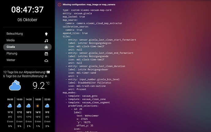

Hey Piotr,
first of all: Thanks for your awesome work!
I’ve been using your Interactive Map Card for quite a while on my wall dashboard - a tablet running kiosk browser. Since a couple of weeks it kind of broke without changing anything in the config:
The strange thing is that the card still works like intended when opened on my desktop browser:
Do you happen to have any idea what might be causing this issue? I tried all the common attempts like restarting the tablet, deleting cache, relogging in the kiosk browser app etc.

map_image and map_camera are properties that were used in v1.x.x versions of a card. Maybe you have two versions installed at once (via HACS and manually)?
Not that I know of. There is only one folder in custom_lovelace.
I just checked again:
It’s working like intended on my Desktop PCs browser.
It shows the error on both my wall dashboard in kiosk browser and in the Home Assistant app on my mobile phone.
I’m at a loss what could cause this on my mobile devices.
ok, so do you have it installed using HACS or manually?
I used HACS to install it.
Ok, so what do you have in custom_lovelace?
Well. Thanks a lot Piotr!
There was actually a folder called xiaomi_vacuum_map_card dated back to 2021. After deleting and restarting everything worked again on my mobile devices! I still don’t know why it didn’t affect my desktop browser, but whatever.
Thanks again for your quick help!
Best regards
Stefan
It probably was caused by order of loading resources. You might also check out if URL of this old version is present in dashboard’s resources and remove it.
