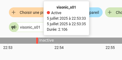

Thanks, here is the log:
siren.visonic_s01 reported as “active” when the event took place:
But of course I didn’t hear anything.

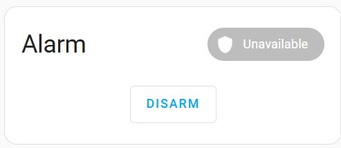

First of all, thanks for the good work. I have a powermax+, question after update version 0.12.0.1, i miss the panel for arm and disarm as it should be. what can i do to get it back?
@ thermostat
For your flood alarm, you’re correct, from your log file the panel creates a “Flood Alert” and then 2 seconds later it reports “Flood Alert Restore”. My integration just does what the panel tells it, and so a flood alert is reported. I do not get siren trigger data and that is why you need to set the siren reasons as part of the integration config. If you have “Flood” in this list then HA will show that the siren has triggered.
@Digiw
There seems to be a problem with PowerMax Pro/Plus Panels at the moment that I’m currently looking at, there are already issues created on Github for it (#194 and #199) I suggest sticking with 0.9.9.9 until it’s resolved.
