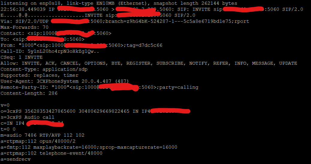

Oef, not that advanced over here. How can I do that? ssh into HA and then tcpdump command which what parameters?
Yeah, sorry, if you are up for learning I can try to describe how I would do it. Start by connecting to HA with ssh, then find out what your network interface is called with the ifconfig command. There might be a few listed so you want the one associated with the IP address you use to connect to HA. Once you have that I would run tcpdump with something like:
tcpdump -i <iface name> 'udp port 5060'
You might want to write that out to a file by adding ‘-w ’. You can then read it with ‘tcpdump -r -A’.
Great, always keen to learn.
See below the output from the network interface when I call the VOIP integration. Basically it rings but it is not being pick-up
There is nothing else in this log
Sorry, I think you will need to add -A to that command to get it to print out the packet contents.

Indeed, see below the output (which then repeats)
Any ideas?
That is interesting, it looks like in the From header there is no space between the description and the actual URI. I’ll have to take a closer look at the SIP spec, I think the space is required.
I stand corrected, it appears in https://www.ietf.org/rfc/rfc3261.txt section 20.10 Contact that
There may or may not be LWS between the display-name and the “<”.
Assuming LWS means linear white space. Looks like we need to update the header parsing to account for that.
