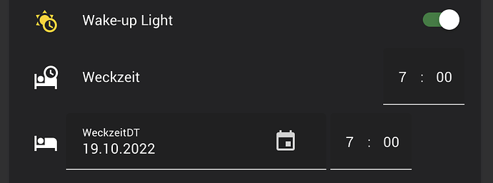

This Wake-Up-Automation is awesome! Thanks for your work.
I don’t always stay up at the same time. Is it possible to adjust the Wake-Up-Time on the “Homescreen” of my HA? I tried with a Time-Helper but as you explained, it doesn’t work. A Date&Time-Helper work but it isn’t nice to change the Date every Day. Any Ideas how i can solve this?
I currently use the innr zigbee bulbs which dim to a fairly low light. I have 2 colour temperature varying ones in our bedside lights that work quite well.
I'm fairly new to HA, but I found a possible solution to your issue. The below reference is a way to set the time helper to a timestamp. However, I did also have to use an automation to update_entity at 2:30 each morning.
I have tried the solution from deathbybandaid but newer got them to work.
I use the today_at function which creates a sensor with todays date. You can then create an automation or a trigger to update the sensor at a given time.
