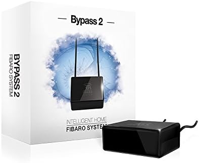

You have to get one of those cheap electrical test screwdrivers. One of those will tell you which wire is live.
Also, remember the dimmer needs a load of at least 20W or something. I’ve had problems with this but you can buy bypasses to make LED bulbs with less wattage work.
Quick question, have you ever tried to use the fiber dimmers solely for sending scene commands and than having a smart bulb like a Hue connected that’s always on?
What are bypasses?
This one:
Fibaro Bypass 2:
https://en.robbshop.nl/dimmer-bypass-2-fibaro
In case you light source does not have enough power to dim (I’m quite sure you don’t need this when you are not using “dim” functions).

@max_yegorov I actually needed a bypass just to get the light to go out, not just to dim it. Actually send back a unit because I thought it was broken but the load was just to small.
Sorry, my mistake, you are right. So that’s why I suggested to “bridge” one switch port (to simulate an always on switch).
That depends on the bulb btw. I’ve had LED bulbs that (without dimming) did not “glow” while switched off.
Yep… I mostly have led bulbs in my house… need to check their power…
