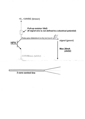

Hi yashjoe,
thank you for sharing your project.
Can you please tell me, which resitor size (Ohm) you have used?
Hi itapower, here you are the resistor and the doc received with the watermeter.

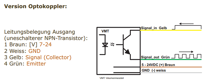

HI,
I bought the “Optocoupler” version and I have an ESP32 30P
As shown in the figure, I connected the brown wire to +5VDC, the white wire to GND and the green wire (Signal_out) to GPIO13.
Between the green wire (Signal_out) and the white wire (GND) I put the resistance supplied by the manufacturer.
Following the manufacturer’s diagram, I connected the yellow wire (Signal_In) to +5VDC.
But I’m not sure what happened because in the ESP32 logs I see that the m3 always increase without the passage of water (or air since they are still on the “test bed”)
Furthermore, among the notes I read that the Optocoupler version does not have the NPN Transistor.
Can any kind soul tell me where I’m going wrong?
Thank you very much!
