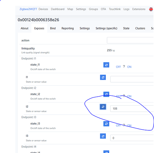

Got it working at the basis, you can see the debugger (for flashing) at the top and the red light indicating magnetic detection.
Now I need to combine this in a case with battery and then connect to the watermeter…so not fully done
yet
Additional finding, 2 AAA not enough to get a signal frm the sensor, the board connects but no sensor… I fear this mayb not gling to work but…QED afetr I get it installed in the next 1-2 weeks
EDIT : First test with the meter, no luck, the sensor does not detect the rotating bit. I have reference for the same meter…so, ordered another proximity sensor in line with the reference.
