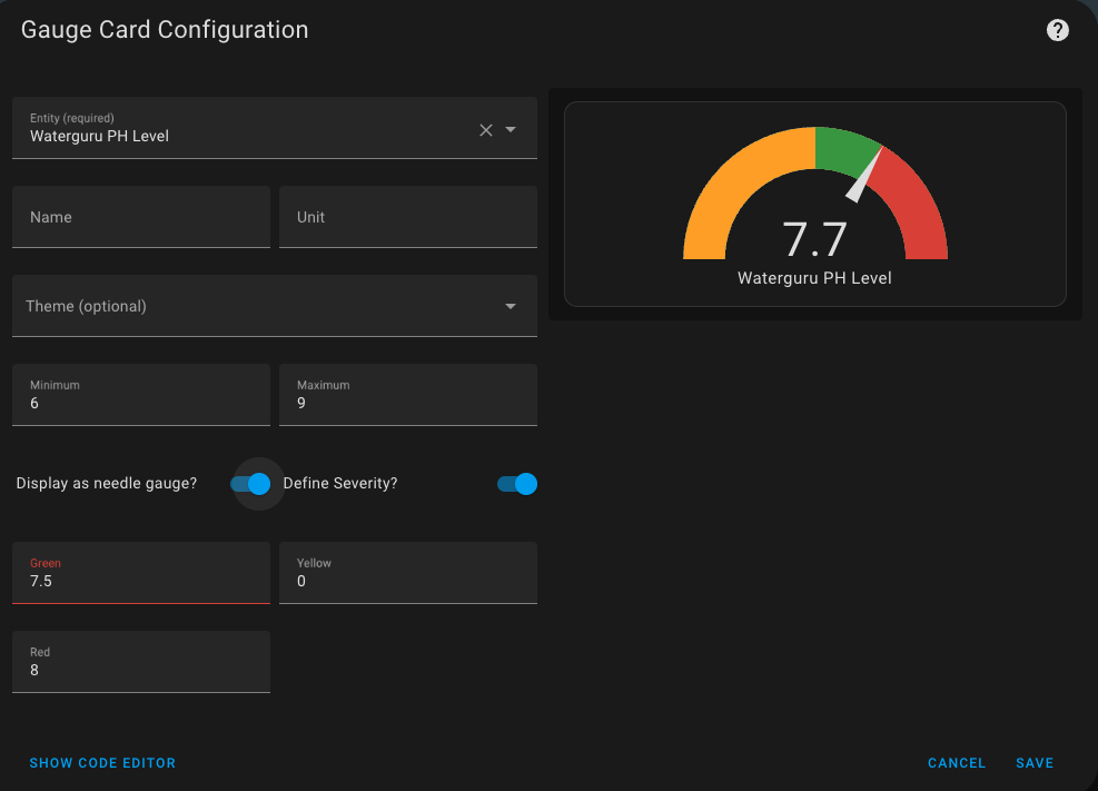

Is it a single gauge? The example I posted is part of a vertical stack.
Here is a UI based configuration for a gauge card, maybe that helps…
I got the gauges working fine. It’s the mushroom cards I’m tripping over. I got this far:
