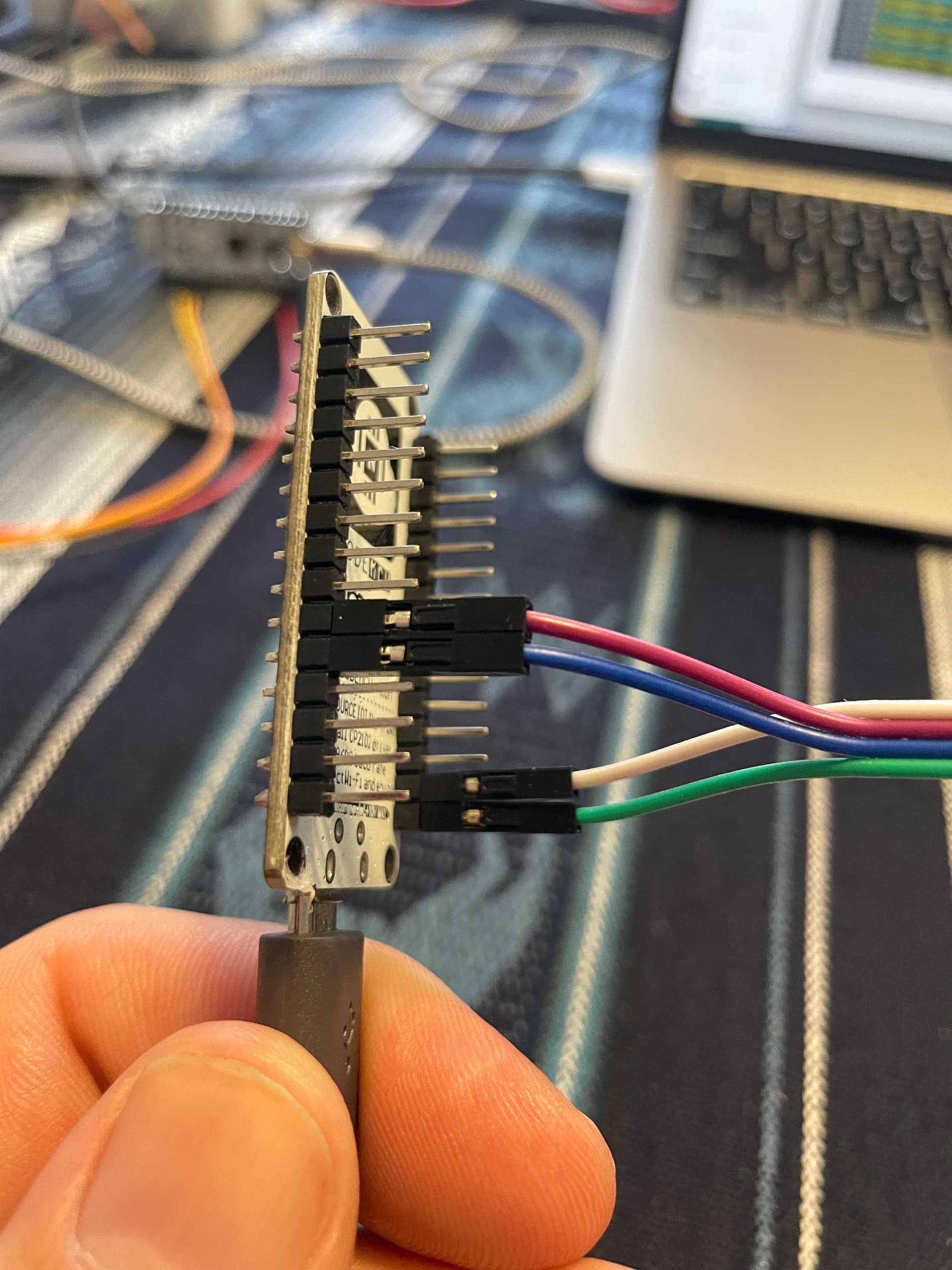

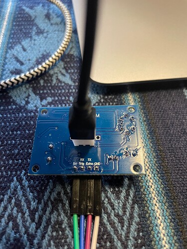

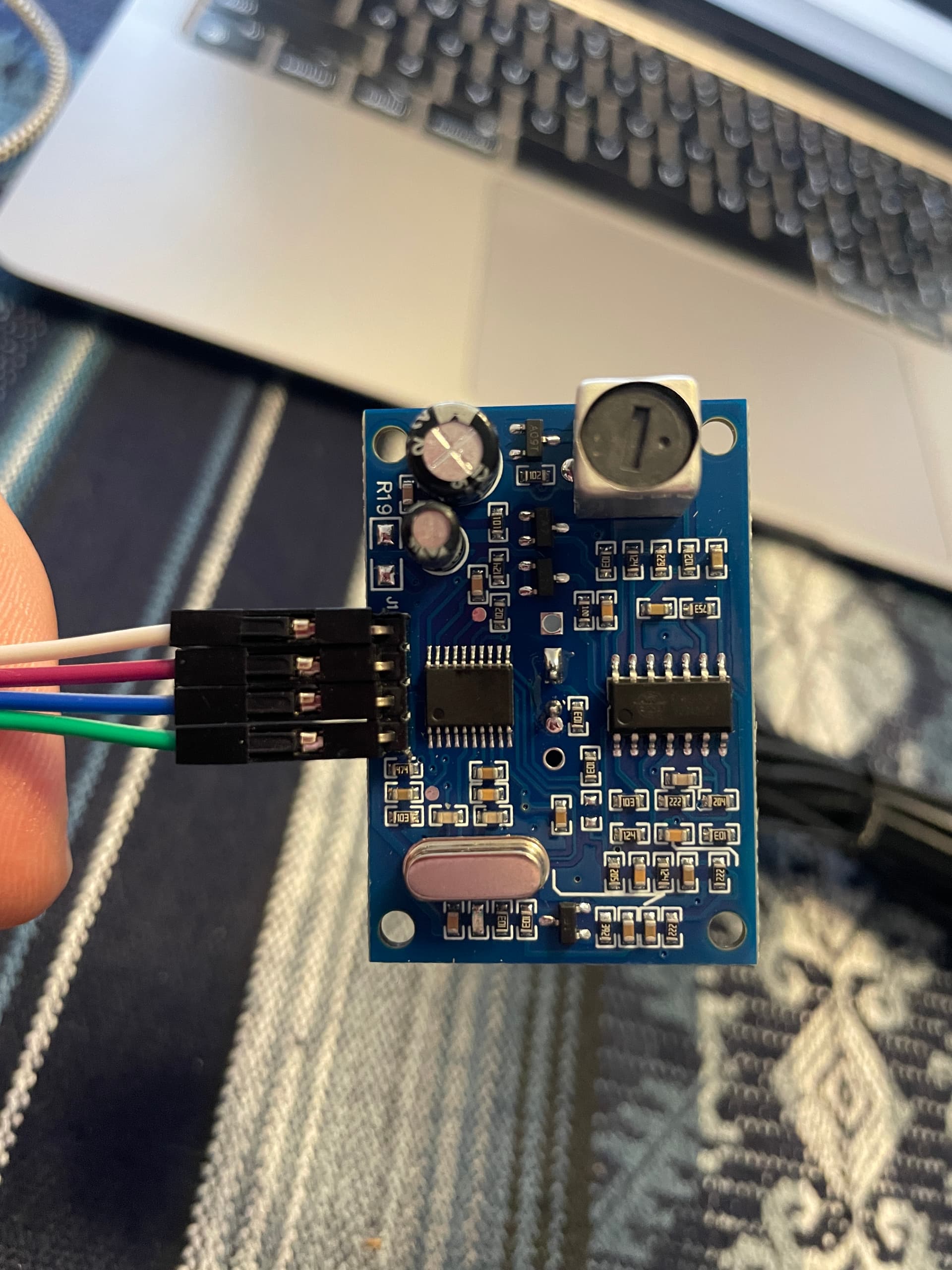

Here are a few pictures of the wiring. I’m not sure if GPIO pins 13 and 15 must be used or whether I could use 12 and 14 or even 4 and 5, there are mixed comments on these elsewhere, but I may try them each later.
