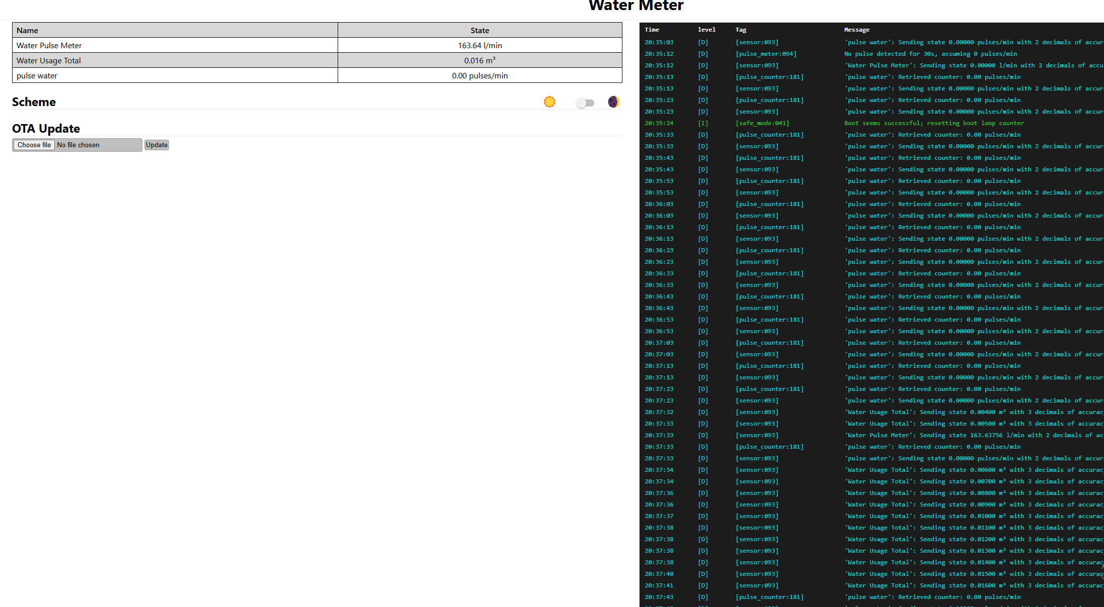

Is anyone else having issues where pulse water does 0 pulses/min but the other sensors work fine?
sensor:
  - platform: pulse_counter
    pin:
      allow_other_uses: true
      number: D5
      inverted: true
      mode:
        input: true
        pullup: true
    update_interval : 10s
  - platform: pulse_meter
    pin:
      number: D5
      inverted: true
      mode:
        input: true
        pullup: true
    name: "Water Pulse Meter"
    unit_of_measurement: 'l/min'
    icon: "mdi:water"
    internal_filter: 100ms
    timeout: 30s
    filters:
      - throttle: 10s
    total:
      name: "Water Usage Total"
      unit_of_measurement: "m³"
      accuracy_decimals: 3
      device_class: water
      state_class: total_increasing
      filters:
        - multiply: 0.001
Im using a d1 mini pro

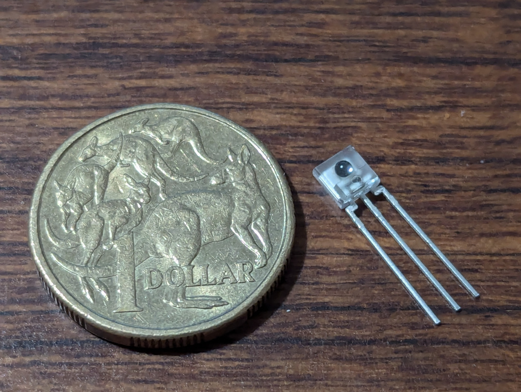

Maybe a side looker light to voltage device like this TSL12S would fit. It would only need 2.56mm space between the emitter and the lid. It can use 5V or 3V3 supply and is very sensitive to red light.

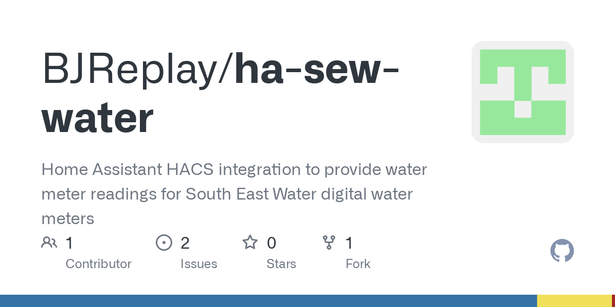

I’m in the same situation as everyone here that has gotten their old school water meter swapped with a smart one, I’m also a SEW customer.
I have tried using this project, however haven’t got it working yet:
Got a back and forward troubleshooting going on with the developer, but still no avail.
I am interested in the local LED emitting option…looks like nobody has been able to get it working yet, will be following this closely.

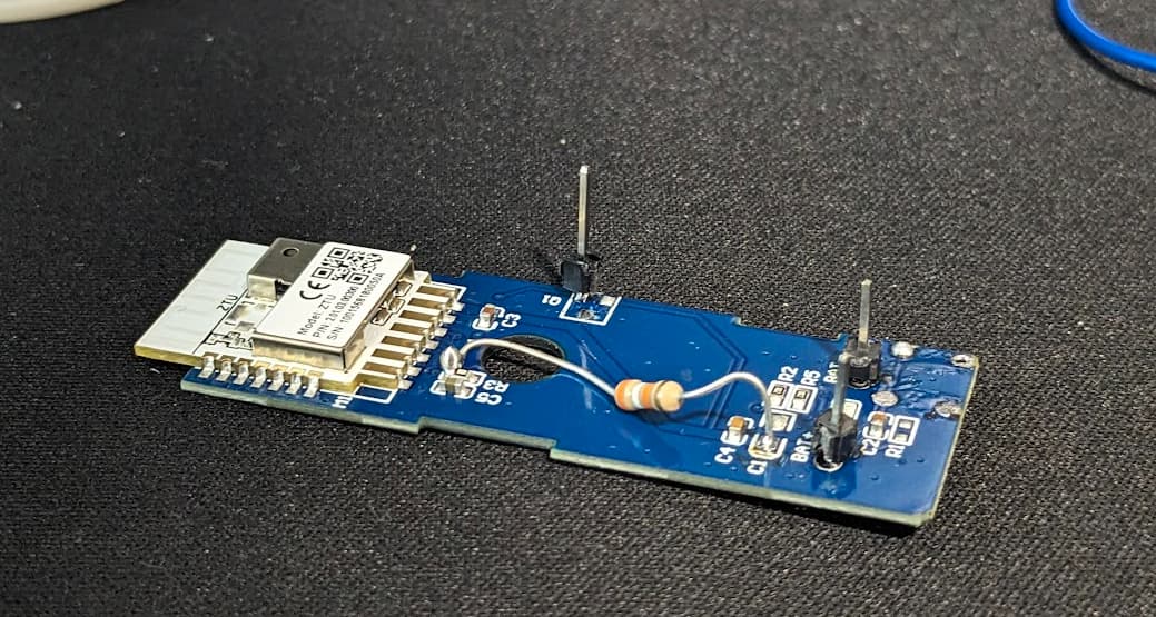

In terms of modifications, it was just a case of opening it up, finding the 3-pin SOT reed switch and desoldering it, then soldering on a connector to wire up my own reed switch.
Mine ended up being a bit bodgy, but something like this:
Centre-top you can see the pads where the old 3-pin switch sat, and I’ve soldered a header pin on instead, which I then took off to some plugs to connect my switch input (with the other end going to GND, from memory - probably verify the pin continuity of what the original was doing with a multimeter to check though).
I don’t actually recall why I added that resistor, but I suspect it’s a pullup on the MCU’s input pin, otherwise removing the chip would leave it floating.
