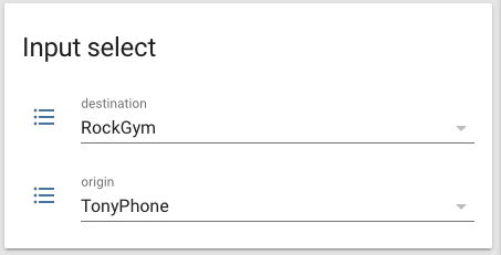

This results in 2 nice input select lists.
54%20PM
The sensor.start_address never seems to update with the input select and the Waze calculations don’t work.
My intention is to call the two input select lists via automation using the input_select.select_option to change the origin and destination for Waze to produce travel timers, which I can then send out via notifications.
