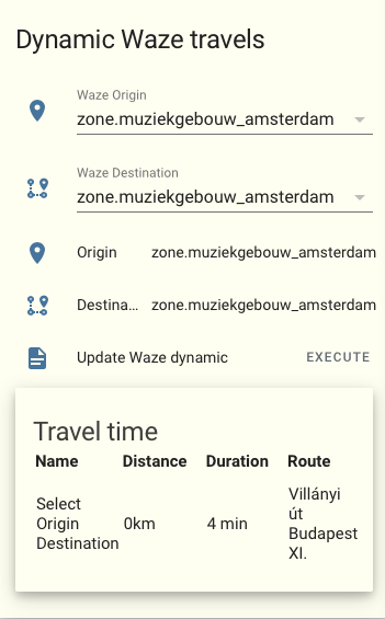

sensor:
  - platform: template
    sensors:
      destination_address:
        friendly_name: Destination
        value_template: >
          {{states('input_select.waze_destination')}}
        icon_template: mdi:map-marker-path
      origin_address:
        friendly_name: Origin
        value_template: >
          {{states('input_select.waze_origin')}}
  - platform: waze_travel_time
    name: 'Select Origin Destination'
    origin: sensor.origin_address
    destination: sensor.destination_address
    region: 'EU'
makes for a fine card in Lovelace:
  - type: entities
    title: Dynamic Waze travels
    show_header_toggle: false
    entities:
      - input_select.waze_origin
      - input_select.waze_destination
      - sensor.origin_address
      - sensor.destination_address
      - type: custom:waze-card
        title: Travel time
        entities:
          - entity: sensor.select_origin_destination
above setup is utterly useless, and Waze returns the most awkward results. Many times it reproduces the exact same impossible route (often via a route in Budapest)…
It cant find the coordinates of the life360 device_trackers, even though they are perfectly populated with all attributes.
About the only thing it does show correctly is when I choose 2 same zones for origin and destination, it shows 0 for distance. But I must go over Budapest… and that would take me 4 minutes :wink:
59
Change your sensor to output the lat,lon, not the name of the entity…
yes, Ive thought about that but this is what the docs say:
Enter the starting address or the GPS coordinates of the location (GPS coordinates has to be separated by a comma). You can also enter an entity id which provides this information in its state, an entity id with latitude and longitude attributes, or zone friendly name.
wouldn’t the current sensor then be exactly what the docs prescribe?
No. You can provide an entity_id and it will look at that entity_id. It does not say it will look at an entity_id then assume that this entity is providing other entity_id’s. It does the following:
Does this entity_id contain lat and lon attributes?
Yes -> use them.
No - > Is this a sensor?
… Yes -> Provide the sensor string to the api. The sensor api requires a comma separated lat and lon or an address.
… No -> Error out.
This is the third time now that a user of the travel_time components thinks that they work this way.
