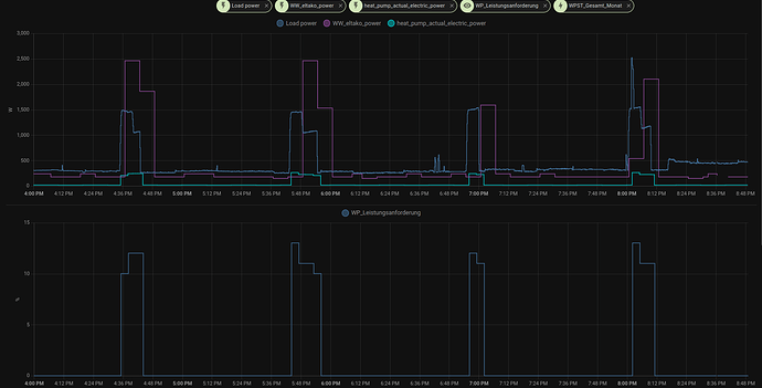

Some more results to share:
measuring the electric power of the heatpump I use an Eltako power meter to measure the electric power (WW_eltako_power) consumed by the heatpump (Details under sesnsors section). Moreover I use the estimation of the heatpump electric power by rafdev (= heatpump_actual_electric_power). Displayed values:
Eltako measurements: WW_eltako_power (value not displayed in the night due to wifi)
Estimated heatpump electric power (by rafdev): heatpump_actual_electric_powers
total household consumption: load power (measured with pv inverter)
You can see that the @rafdev18 estimation is quite good (I need to scale this value up and thats it I guess :slight_smile:
However also my eltako even though i use the S0 interface (which is a pain - is not so bad - also this value requries some scaling factors).
@MarkusLacht - yes you are absolutely right - if the hot water temperature did not drop yet bellow the 5 Celsius from the set temperature then the push command will not trigger.
For me not an issue as I only do a hot water push at 2 pm and 24h later the temperature difference is correct.
@MarkusLacht - this is pretty cool - thank you for reconfirming the consumption calculation based on the the Leistungsanforderung value.
I would be interested in the adjustment you need to make in order to better hit the measured values. I am pretty happy with the result but there is always room for improvement.
BTW I am able to calculate also based on the sensor the amount from grid and solar power for my heat pump and can display this accordingly :wink: just if you are looking for your next project.
