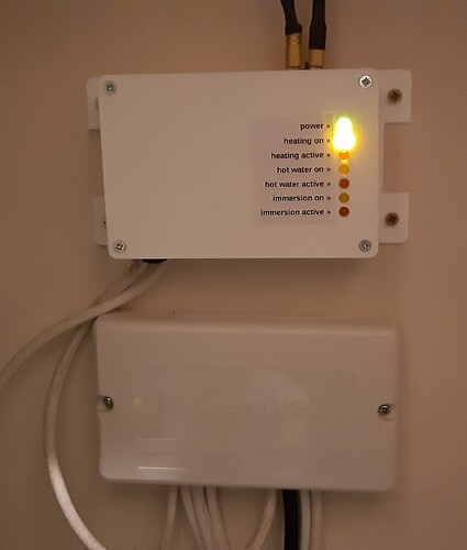

I’ve also replaced the heating unit with another DIY unit using an ESP8266 and a couple of relays controlling the boiler and the hot water controls.
