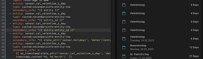

My use case is: I want to list ~30 (German) holiday dates. I use the Calendarific integration to create the sensors. They contain the number of days until the holiday. In the entities card I additionally want to display the exact date of that sensor, which is an attribute of the sensor. This works fine, in English:
The yaml code for the entities in the entities card looks like this for the first 3 of ~30 entities:
- entity: sensor.cal_valentine_s_day
type: custom:secondaryinfo-entity-row
secondary_info: >-
{{ as_timestamp(state_attr('sensor.cal_valentine_s_day', 'date')) |
timestamp_custom('%A, %d.%m.%Y') }}
- entity: sensor.cal_rosenmontag
secondary_info: >-
{{ as_timestamp(state_attr('sensor.cal_rosenmontag', 'date')) |
- entity: sensor.cal_st_patrick_s_day
secondary_info: >-
{{ as_timestamp(state_attr('sensor.cal_st_patrick_s_day', 'date')) |
