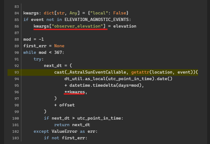

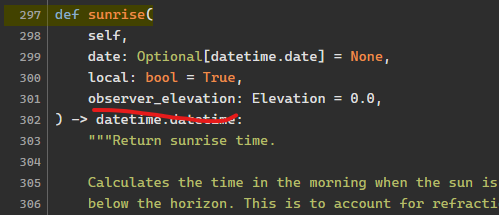

Dude, quit pulling things out of thin air and read the code please. Here’s the calculation HA uses:
And here’s where HA uses it in the code, you can see we are calling a direct getattr on the Location object, i.e. pointing directly to the function in the previous link:
