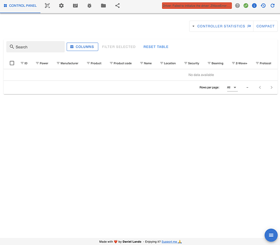

After a YEAR of frustration and thousands of dollars, my Z-wave network is now completely non-responsive after a recent HomeAssistant and/or ZWave JS UI software update:
Am I completely screwed? I have about 80-100 devices (many of which are light switches that are not easy to access internally (to see QR codes) and/or cut power to). I have tons of dashboards, scripts, etc. referring to these devices that it will be a nightmare to rebuild (and frankly, why would I given the unreliability of this technology???). I have tons of backups… Is there any hope of getting things back or should I just cut my losses and give up on this garbage system?
What does the error say?
FWIW, I’ve been using zwave for ~10 years with almost no major issues or fiddling.
The error is in the red box at the top of the screenshot: “Driver: Failed to initialize the driver. ZWaveError…”
yes, we need to see the remainder of the error after the …
Look in the zwavejs ui logs for the error.

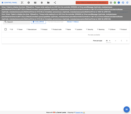

Driver: Failed to initialize the driver: WaveError: Timeout while waiting for an ACK from the controller (ZW0200) at Driver.sendMessage (/opt/node_modules/zwave-js/src/lib/driver/Driver.ts:6977:23) at ZWaveController2.queryCapabilities (/opt/node_modules/zwave-js/src/lib/controller/Controller.ts:1061:37) at Driver.initializeControllerAndNodes (/opt/node_modules/zwave-js/src/lib/driver/Driver.ts:1913:46) at Immediate. (/opt/node_modules/zwave-js/src/lib/driver/Driver.ts:1639:16) (ZW0100)TICS * COMPACT
Error: Driver: Failed to initialize the driver: ZWaveError: Timeout while waiting for an ACK from the controller (ZW0200) at Driver.sendMessage (/opt/node_modules/zwave-js/src/lib/driver/Driver.ts:6977:23) at ZWaveController2.queryCapabilities (/opt/node_modules/zwave-js/src/lib/controller/Controller.ts:1061:37) at Driver.initializeControllerAndNodes (/opt/node_modules/zwave-js/src/lib/driver/Driver.ts:1913:46) at Immediate. (/opt/node_modules/zwave-js/src/lib/driver/Driver.ts:1639:16) (ZW0100)

Take a look at this thread (which links to another)
Your current system is more than adequate.
Some google fu reveals others have experienced your problem. If you haven’t already:
  1. Do a proper shutdown on the HA Yellow.
  2. Remove the USB Zwave controller.
  3. Power up the HA Yellow.
  4. Proper shutdown the HA Yellow.
  5. Reinstall the USB Zwave controller (make sure you’re plugging it back into its original slot.)
  6. Power up the HA Yellow.
Let us know what happens…
Thanks so much for the pointer, @JohnBeMe ! That got my controller working again. (For anyone else reading this, the TL;DR is: 1. shutdown your home assistant. 2. Remove the usb Z-wave controller. 3. Boot your home assistant. 4. Shutdown your homeassistant. 5. Re-insert the USB z-wave controller. 6. Boot your home assistant.)
