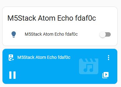

I had the same problem. In case M5Stack Atom Echo was not on the same network as HA, there is a problem. Now it works, but there must be some reruting needed in another case
