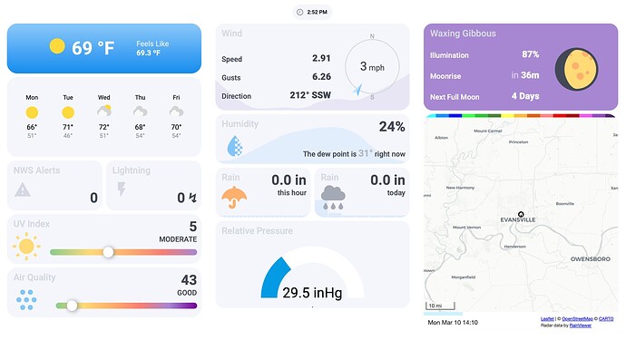

WIP - Weather Dashboard
Nice work!
Can you please share a yaml?
When I get it completed I will share yaml for each individual card.
You’re not done yet? It already looks good. I wonder how you’ll improve it :grin:
Waiting for the update. Thanks! :slight_smile:
I should have it done this weekend. Going through and cleaning up and simplify code.

im intrested in the diffrent card names.
I really like UV Index und Air Quality card!
The UV and Air Quality card are custom button cards. Below is the air quality:
UV Index

Thanks :slight_smile:
Can you share the picture too please ? :slight_smile:
Icons are pulled from this HACS integration
https://github.com/thomasloven/hass-custom_icons
The wind card is finished ?
Nice icons thanks for this integration :slight_smile:
meteo
Yes. It uses custom button card and mini-graph. The images for the compass rose are svg’s I created (I will post those tomorrow, don’t have access to them currently):

Thanks a lot !
What’s your integration for monitoring wind please ?
I pull data from an Ecowitt wittboy weather station.
https://shop.ecowitt.com/collections/lan-wlan-weather-station/products/wittboy
Nws alerts card please :grin:
Just recently updated this one. It will now list and scroll through the warnings.

styles:
  grid:
    - grid-template-areas: |
        "n n s"
        "i list list"
    - grid-template-rows: min-content 1fr
    - grid-template-columns: min-content 1fr min-content
  card:
    - height: 115px
    - padding: 10px
    - background: var(--orange)
    - border-radius: 20px
  name:
    - font-size: 1.5rem
    - font-weight: 500
    - justify-self: start
    - align-self: start
    - padding-bottom: 10px
    - color: var(--contrast14)
    - padding-left: 5px
  icon:
    - align-self: center
    - width: 2.5rem
    - height: 3rem
  img_cell:
    - width: 2.6rem
  state:
    - font-size: 2rem
    - font-weight: 600
    - align-self: start
  custom_fields:
    list:
      - font-size: 1.5rem
      - font-weight: 500
      - color: var(--white)
      - text-align: left
      - padding-bottom: 5px
      - padding-left: 10px
      - align-self: end
state:
  - value: 0
    operator: "="
  - value: 1
    operator: ">="
    styles:
      card:
        - background: var(--red)
      name:
      state:
      icon:
        - color: var(--yellow)
  - value: unavailable
    styles:
      name:
        - text-decoration: line-through
      icon:
        - color: var(--contrast12)
      img_cell:
        - background: var(--contrast4)
      card:
        - opacity: 0.6
        - pointer-events: none
    label: Unknown
    icon: ph:question-duotone
Here are the links to the 2 svg files used in the wind card:
Compass Arrow
Compass Directions
